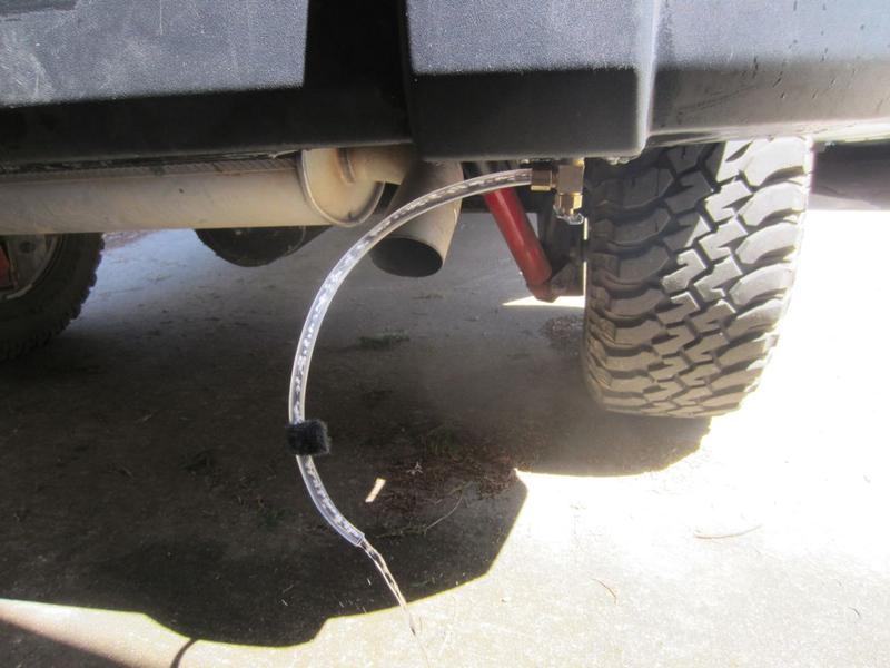

Used a 3/8 x 1/4" brass valve for the outlet, with plastic tubing. The piece of velcro holds it up under the bumper when not needed.
Attachment 446864
Attachment 446864
