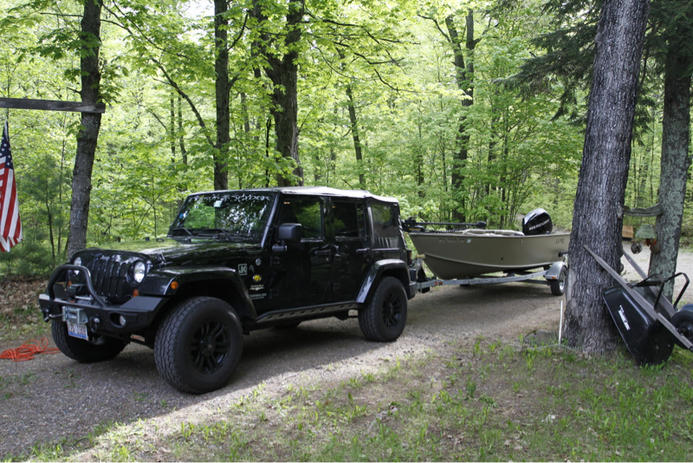

I towed this boat for about 1000 miles round trip. Boat with gas and gear was about #2500. No problems other than gas milage which about 14mpg. Because of the aerodynamics it is easier than pulling a box trailer. I have the 3.7 gears like you.

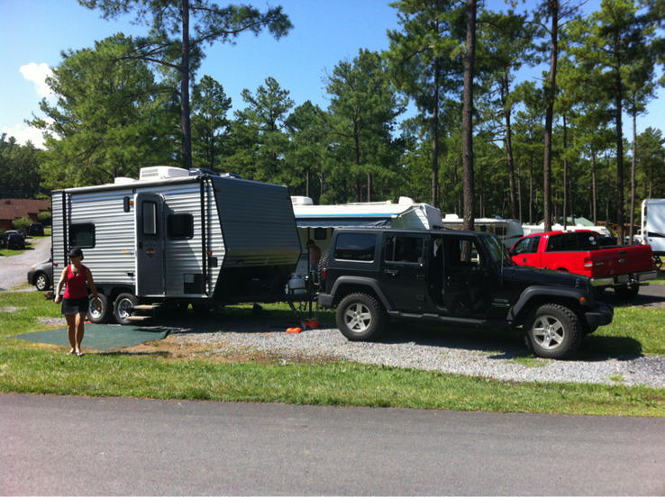

I tow a fleetwood evolution 3 popup camper. It's tongue weight is 400 and its dry weight is 3000lbs. Usually it's loaded up a bit more so I'm probably pushing the 3500 max.
Now I'm running a stock 2007 engine on a man trans with 4.88 gears but it tows fine. A little weak on large hills and I feel it a little around town when breaking and taking off. By highways are smooth.

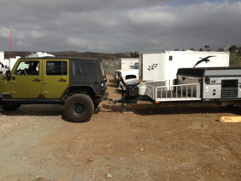

Here is my coachman blast toyhauler. 3500 dry, probably 4500 loaded with the bike inside. It like a big, unaerodynamic box. My 2012 handles it. Towed it over 4000 miles. I have manual trans, max tow with 3.73 rear. I'm not sure the 3.8 would handle it but the 3.6 does good. MPG drops to around 11 from 17.5. All safety precautions need to be taken, including driving very conservatively.
