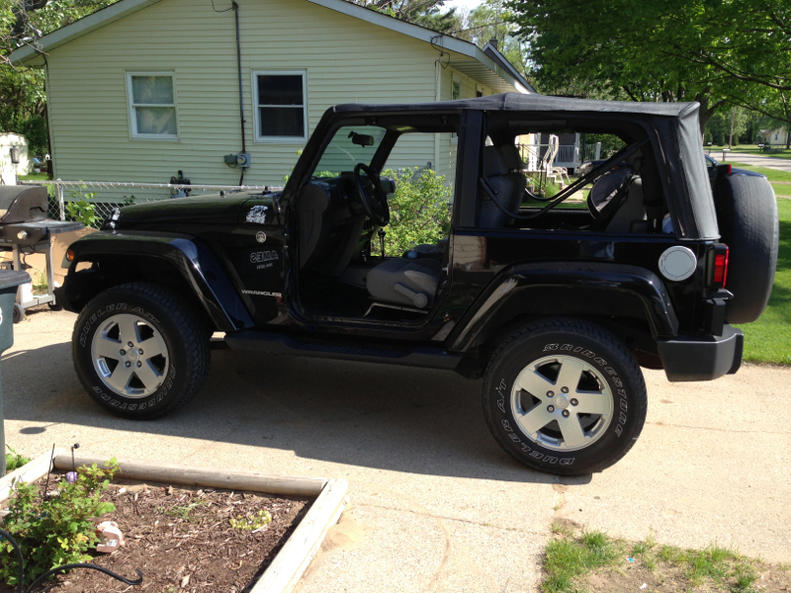

Well I have owned my jk for a little over a yr. first thing I did was take off stupid Sahara decals. Then lift 2.5bb (rough country and rubi shocks)
Tried all last summer to get the doors off. Never had any luck. So today as I am on vacation I was determined to make it happen. So against my better judgement( and my wife's) I got out the old floor jack and a few 2x4s and a towel or two. Took about 2 hrs to work the free without breaking anything but

It took me a few hours to break my JK doors lose too on my 4 door. I made a youtube video of it during the process when I thought hey this might make a good video. I ended up using our floor jack as well cause no matter how much hell I gave it, all I was doing was rocking the hell out of the jeep. Doors wouldn't budge. I was like you though, determined as hell once I decided that's it, they're coming off no matter what.
I put Anti Seize on them now before dropping them back into the mounts. Just wipe off any extra. It makes taking them off super easy.

Lol yeah I use white lithium grease not sure. That was the right choice though tries to get then off today and its a mo good without the jack still I can at least move them a bit but not all the way
Question looks like the bushings may be shot any ideas on replacements?
