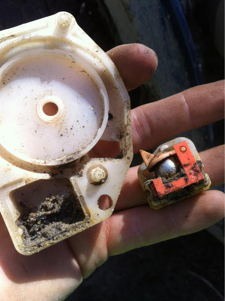

finally figured out seat belt problem
I finally got tired of all my seat belts constantly locking up and jamming and not coming out so i decided to figure out the problem. after popping off the piece of plastic on the side i took it apart and found out what had been jamming it up. there was just a bunch of mud jamming the ball so it wouldnt release, easy enough fix and took about 5min for each belt and now all work great!!
