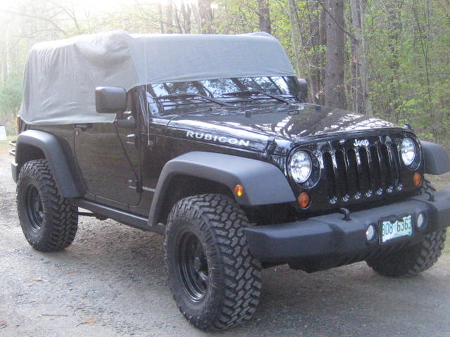

I traded it in they wont be able to fix it right youl be going back and forth adjusting door headers and rubber moldings and youl still be wet on the passengers side I got my 12 rubicon no leak at all in soft top dry floors no drips on door handles inside my 11 I had to leave face cloths there when it rained lol knowing it would drip they said no roof replacement cuz it will leak again they sold me some convertible top conditioner lol cost me 22 bucks I used it inside and out it stunk but worked some what on seams , however do yourself a favor buy a throw on type cover cheap like 40 bucks it takes and defers the rain it repels too but even if its wet through and through it won be in a concentrated area it dissipates or disperses water to prevent it from going in but you cant use it at walmart or shopping lol at night though its great keeps bird shit and pine sap off too I still like mine
some times in a rain storm I run out toss it in a big pile dosnt have to be on neat just cover it some how lol good luck but usually they don't fix the leak they will say all jeeps leak but not true least two years so far none but if it does I know the cover helps a lot
