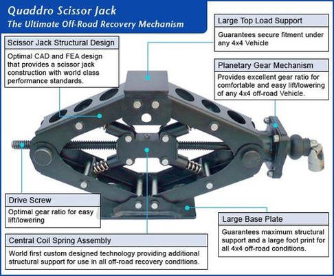

But as far as a scissor jack, I always thought this design was the bomb....
http://www.quaddrotech.com/index.html

The Quaddro Scissor Jack that was pointed to here (and which will be launched next month), seems to be very well designed -
Quaddro Technologies - WORLD'S SAFEST 4x4 Off-Road Vehicle Recovery Mechanism.
