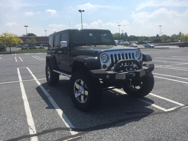

Anyone on here store there JK for a long time (like 6 months) and had any issues? I have a '12 JK 4.5" AEV lift, axles gussets- gearing redone with winch a synthetic line. I just covered it, pulled battery and filled the tank. Am I missing something or should I watch for something? Driving a Audi A4 Quattro as a DD.
