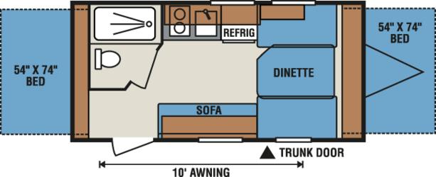

Spree Escape E16RBT pics:

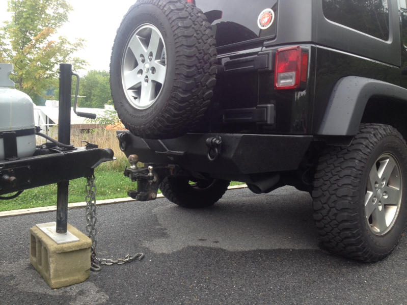

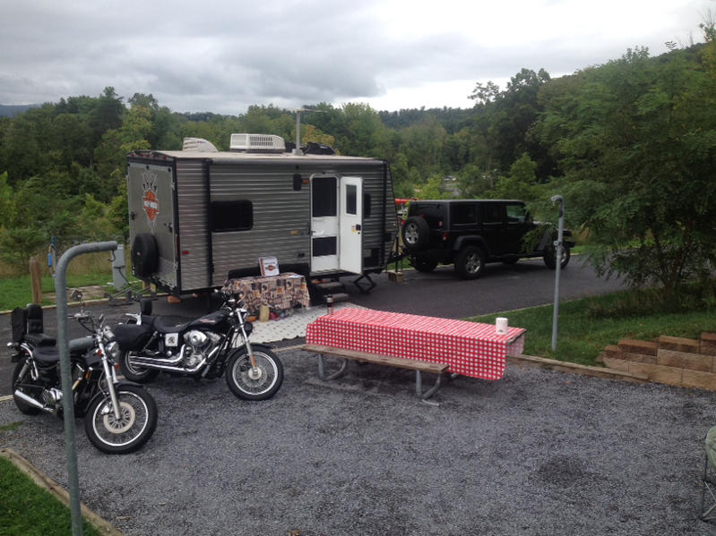

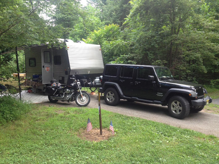

I have commented on many towing topics on here. I just got back from towing a box shaped toyhauler that weighed around 5000 pounds. I have a manual trans 2012 JKU with 3.73 rear. I use a weight distribution hitch. My trailer has dual axle brakes and I have a prodigy 2 brake controller in the jeep. I have towed this trailer around 6000 miles over the past 2.5 yrs. I recently upgraded the rear bumper to the Smittybilt XRC which rates the bumper to 5000 pounds. I can't believe how much this bumper improved my tow and I posted about this in the stock part of this forum. I can't comment on the 3.8, but my 3.6 handled the tow from NJ through PA and into western Virginia without problem. Would I tow in the Rockies? Probably not, but I have been all over Nj, PA, VA, and NC without problems.
