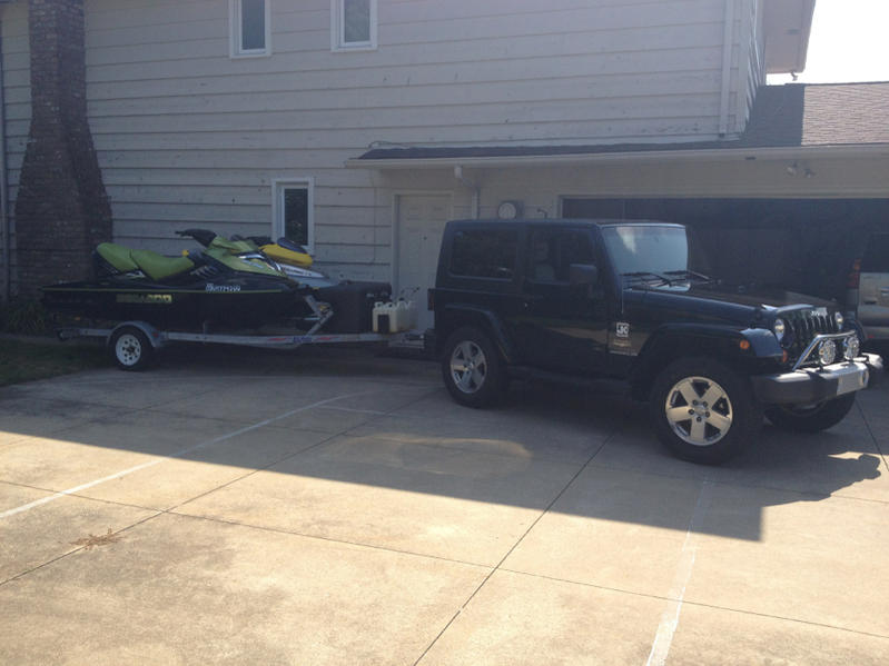

This weighs in at about 2000 lbs, right at the limit and I've had no problems. The 3.8 has been totally fine towing for me. And mines an auto.

Dang, right at the limit with two jet skis? I'd probably be way over the limit with a 18' boat then.

Had a 1800 pop-up camper towed fine for the most part w/ and auto. You can definitly feel the weight push you around from time to time. I did upgrade to drilled/slotted rotors and hawak pads. Make a difference.
Yeah. One weighs about 800 lbs and the other about 600 lbs dry. 35 gallons of fuel combined between the two which is about 220 lbs. About 400 lbs for the double trailer, throw in some gear and I'm probably a little over 2000. It's always towed like a champ, those with pre-2012 autos should invest in a trans cooler and I've never felt like I needed improved stopping ability but I'm sure as mentioned in one of the above post it can help.
