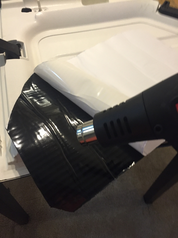

Setting a freedom panel on my work bench (dining room table if you're going to be technical about it) and lined up the boom mat. Starting with the narrower end, I peeled back about 6" of the backing paper and used my $20 heat gun from harbor freight to make the tar adhesive tacky. Forget patchouli, this still smells amazing. Now I very carefully lined up the corners and used my hand to press the first bit to the fiberglass. Phew, I did it right. Using the supplied hand roller, I rolled the boom mat, squishing it down onto the freedom top. Rinse and repeat, un peeling about 6" at a time, heating it, laying it and rolling it. Once I got it all layer down, I gave it one more pass with the roller and everything is good. Then I grabbed the foam insulation, peeled the backing tape and started to apply that with the same technique (minus the heat gun). Rolled it as I went 6" at a time. Take your time with the foam, if you rush it and air gets trapped, it will create bubbles. If this happens you can use the tip of the exacto knife to pop it, then hit it with the roller.
