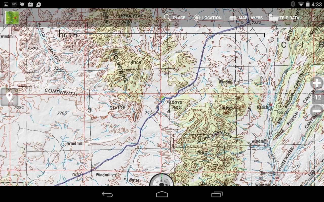

Some screenshots ...

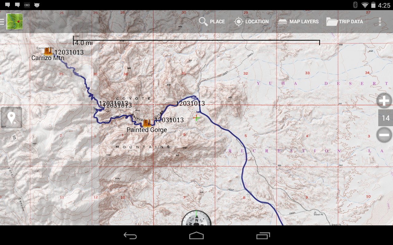

Recording of our route up Carrizo Mtn near Ocotillo, CA ...

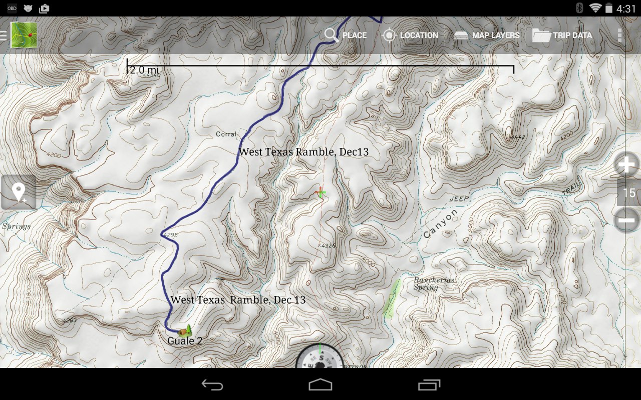

Recording of our route to Guale 2 at BBRSP, TX ...

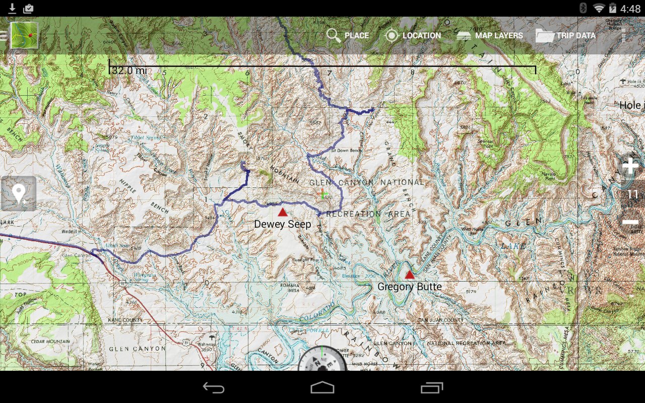

Recording of our route during a trip through the Gila National Forest, NM ...
Recording of our route during a ten day, 463 mile off-road trip from Gateway, CO to BLM land on the north rim of Grand Canyon National Park, AZ. This is where we spent a couple days exploring around Lake Powell ...

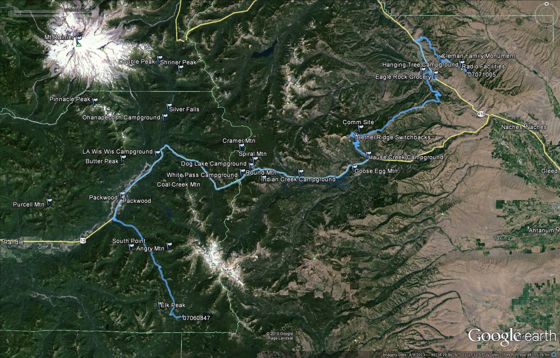

This is what an exported route from BCN looks like when imported to Google Earth. The symbology changes, but otherwise the data is all there. This was day two of a six day, 612 mile mostly off-road trip from Hood River, OR to Nighthawk Crossing on the Canadian Border.
