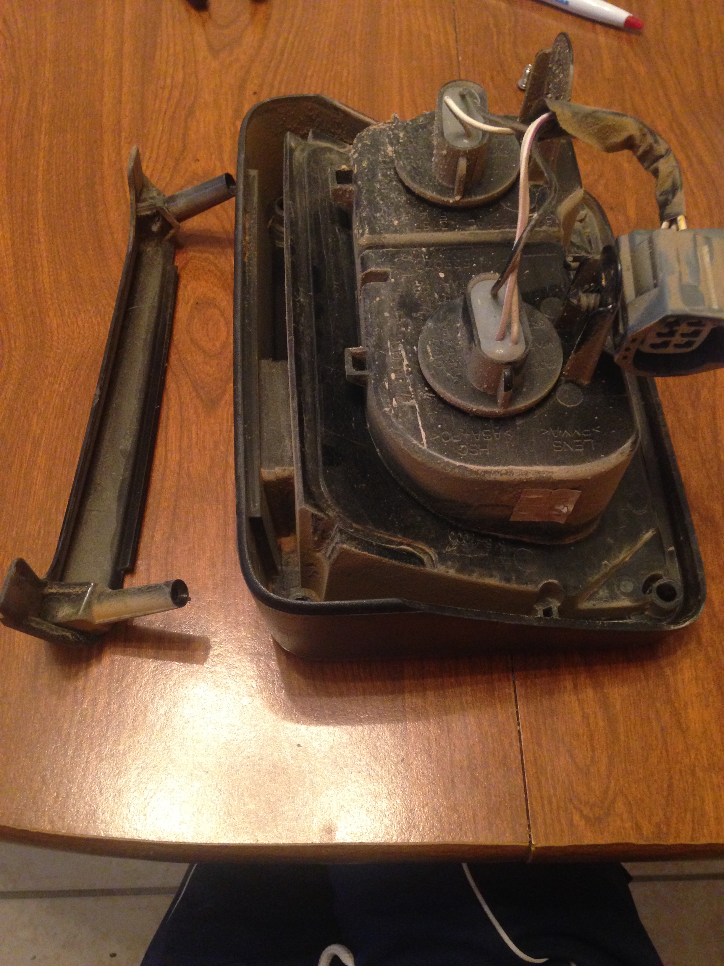

With the light removed, you can take the light and work someplace comfortable. I opted for the kitchen table. There is a small piece of curved plastic that helps contour the light to the back of the Jeep. It may have already detached when you removed the light in Step 4, but if it didn't, go ahead and set it aside now.

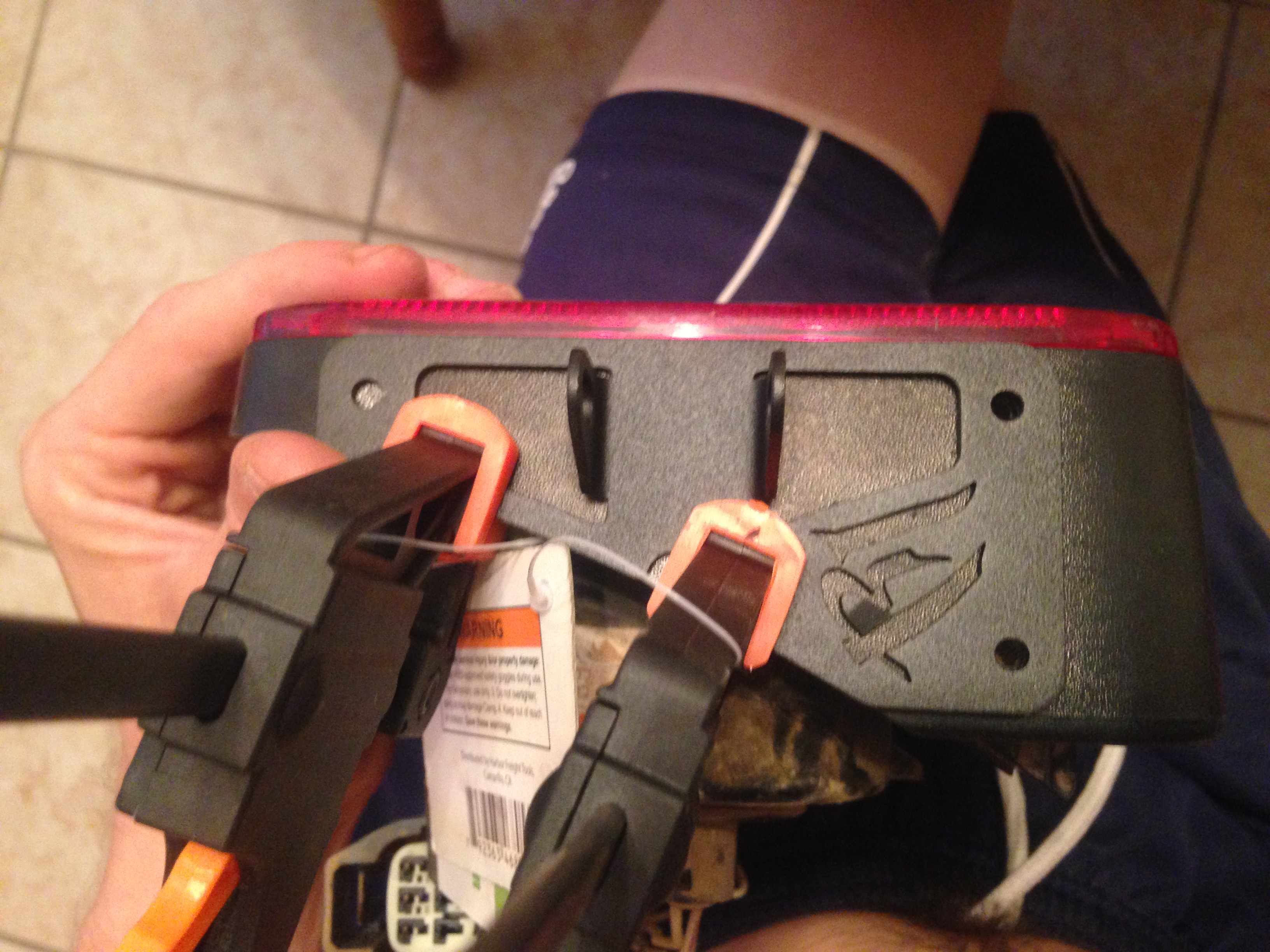

STEP 7:

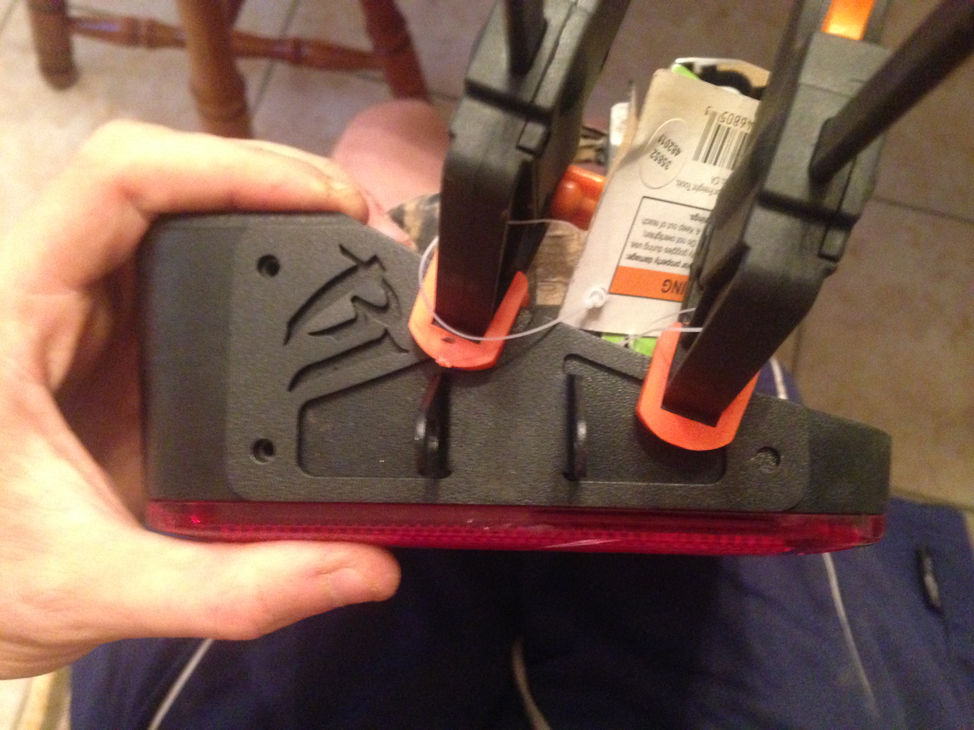

With the two holes drilled, place the mount back on top the light and realign like you did in Step 1. With the mount in the right spot, clamp using 4" bars. I got mine at Harbor Freight.

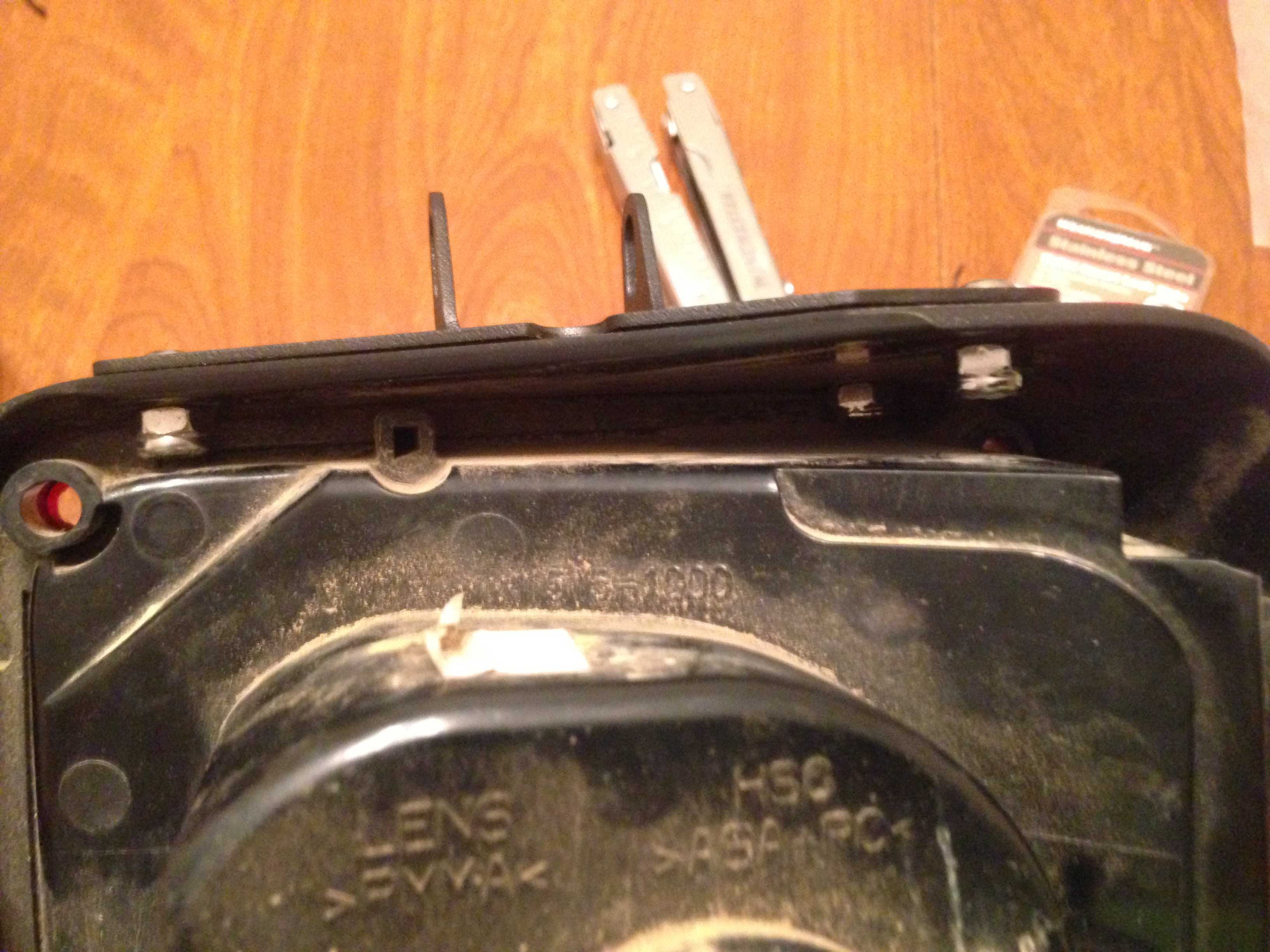

STEP 9:
Using the supplied screws and nyloc nuts in the Rigid kit, twist in the button screws until the tip of each screw is just flush with the inside of the tail light housing. You may have to use a 8/32 hex key to twist the screw in since the hole will be very tight. Starting with the screw closest to the rear of the light, using a pair of Needle Nose Pliers, slip a nyloc nut over the screw and hold in place. Use the hex key to turn the screw until the nut tightens all the way down. This step can take awhile and there isn't much space to work with, so be patient and take a break if you need to. Once the back screw/nut is tight, repeat for the screw in the front. Here is a photo of me working on the second nut.

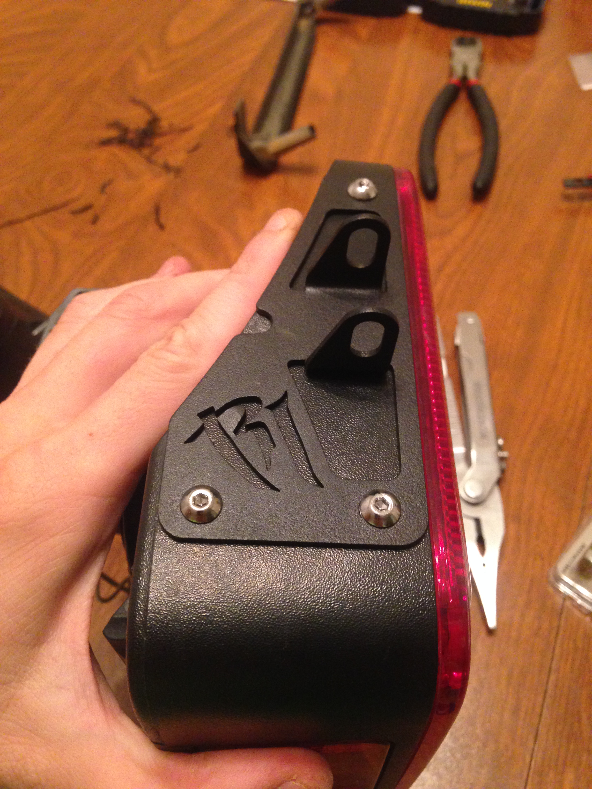

When all is said and done, it should look like this:
STEP 10:

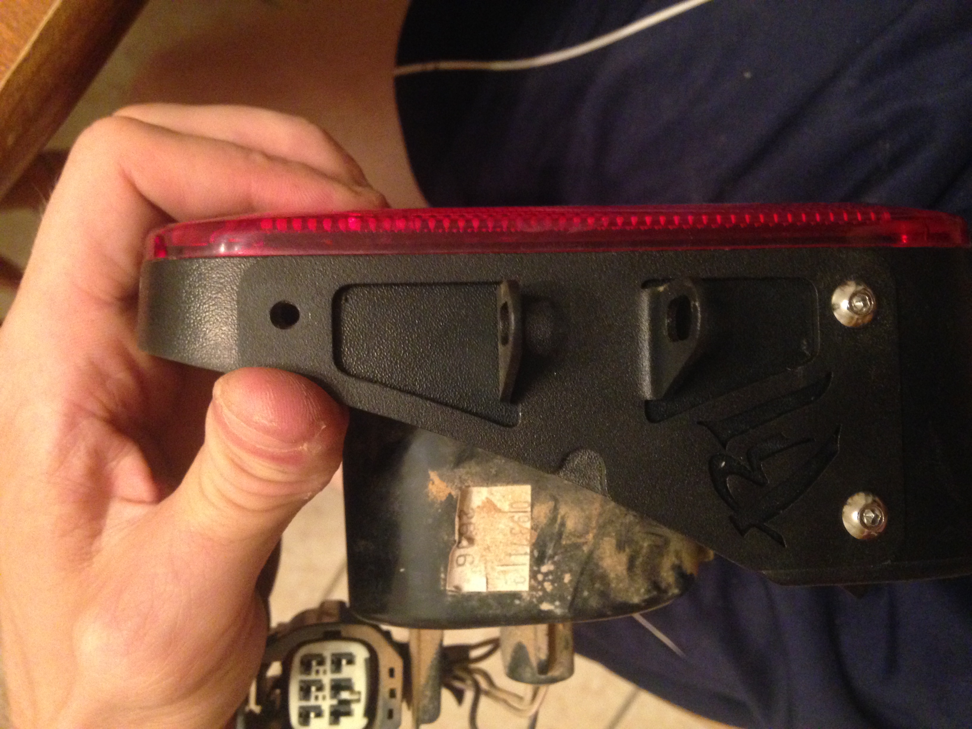

Now you're ready to work on the drilling the last hole. Since the two screws are holding the mount in place, remove the clamps, you won't need them anymore. I opted to just use the 5/32 bit to drill the last hole since the mount was pretty snug, but feel free to drill a pilot hole first if you want to. I found using my thumb to apply gentle pressure to the mount to keep it in the right spot really helped.
STEP 11:
Use the procedure described in Step 9 to secure the last screw/nyloc nut. Once everything is tight, double check to make sure everything is flush. This is important because the light won't sit tight against the Jeep if it isn't. Adjust as needed and proceed once everything is flush/aligned.

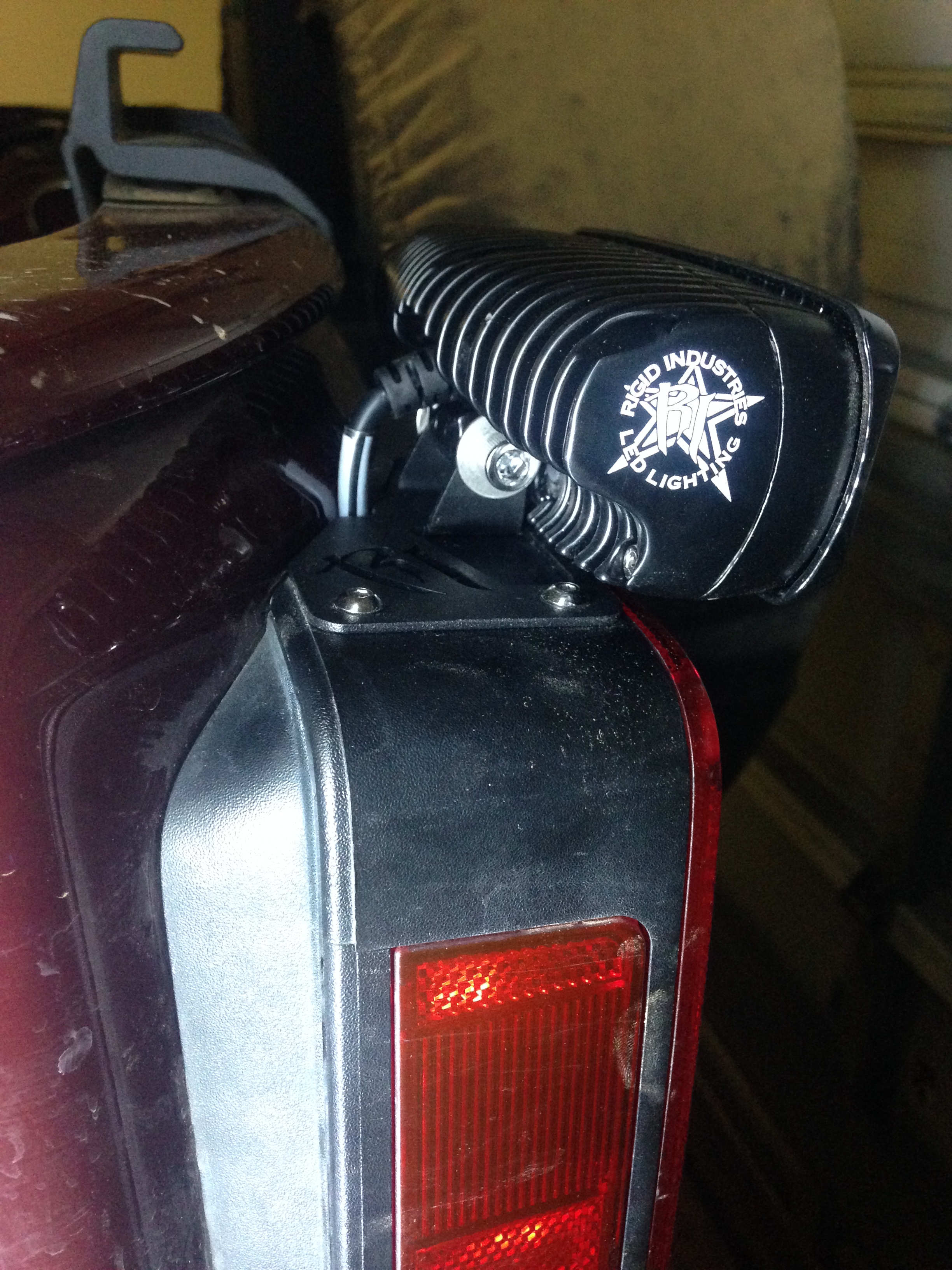

STEP 14:
Now you're ready to attach the light to the mount itself. To prevent scratches to the light, put the supplied lens cover on the light before going further. With the light protected, using the supplied hex bolt/washers/nyloc nut in the SR-Q kit, use the hex bolt to secure the light to the mount. MAKE SURE YOU'RE MOUNTING THE LIGHT FACING THE RIGHT WAY. A 3/16 hex key is needed to tighten the bolt. NOTE: you will want to position the washers on each side of the mount before running the bolt through; the baffles/heat sink on the light will prevent you from snugging them tight if you don't. RECOMMENDATION: I opted to have the hex head end of the bolt points towards the outside of the Jeep (when the light is remounted) to aid in aiming the light later.
STEP 15:
Tighten the hex head bolt all the way into the nyloc nut. It helps to use a 12 mm crescent wrench and a hex key handle to hold the nut in place and get the extra torque to get everything tight.

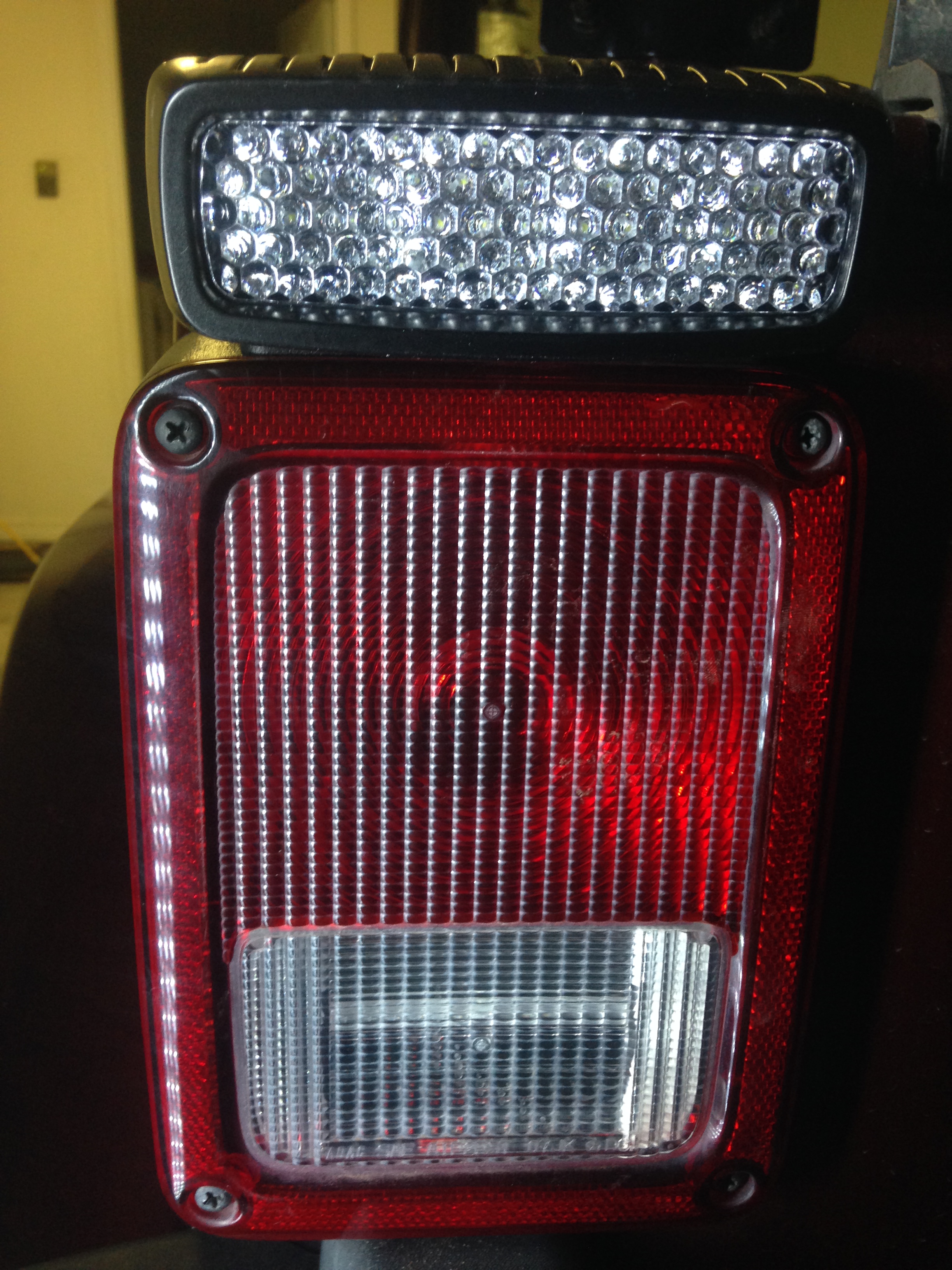

STEP 16:

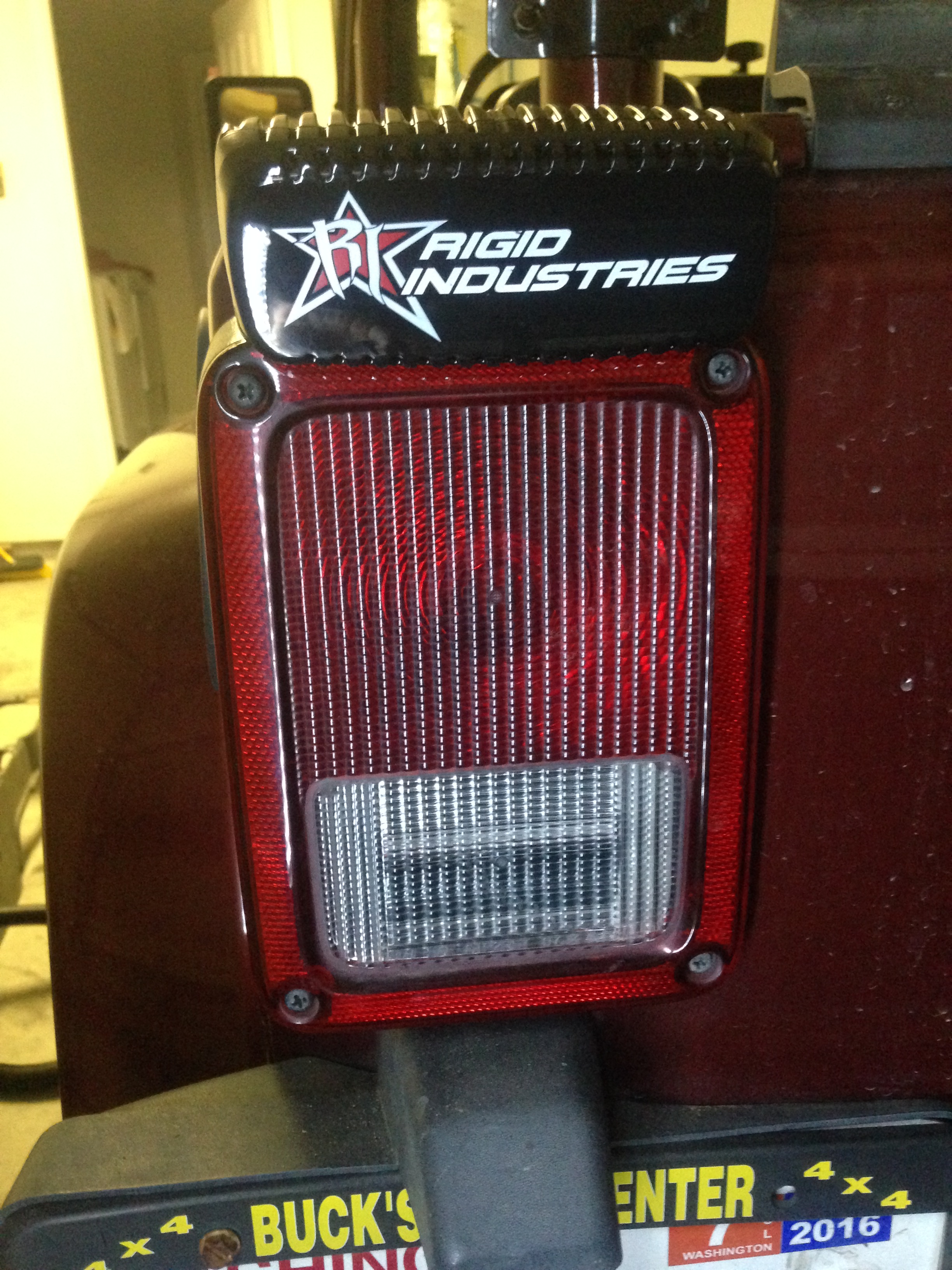

With everything done, you're ready to start the wiring process. Take the entire tail light back out to the Jeep, and don't forget the curved plastic piece you removed in Step 5. I test fit everything before starting the wiring process just to make sure everything fit. Pretty sharp looking!
ID:	649361 Click image for larger version
ID:	649362 Click image for larger version
ID:	649363 Click image for larger version
Simply repeat the above steps for the passenger side light mount.
