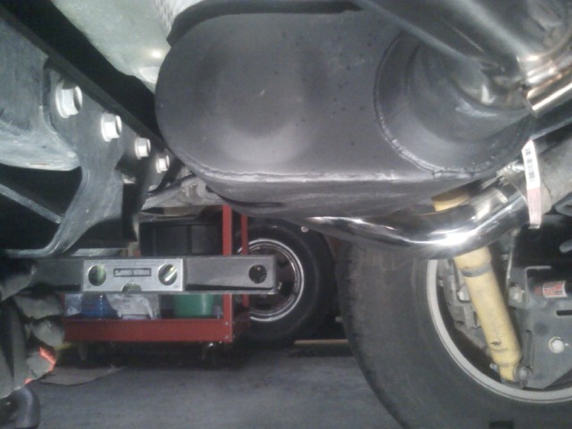

Just put this on a few days ago. As you can see from the pics, it sits nice and high. Lots of ground clearance for backing up in tight rocky places without taking out the muffler.
The muffler fits in between the studs that hold the muffler heat shield on, otherwise those (rather long) studs would potentially hit a muffler this close to the heat shield. This was a good time to take off the heat shield and clean it, and add fender washers under the nuts. Replacing the rubber hangers that support the muffler was also in order.

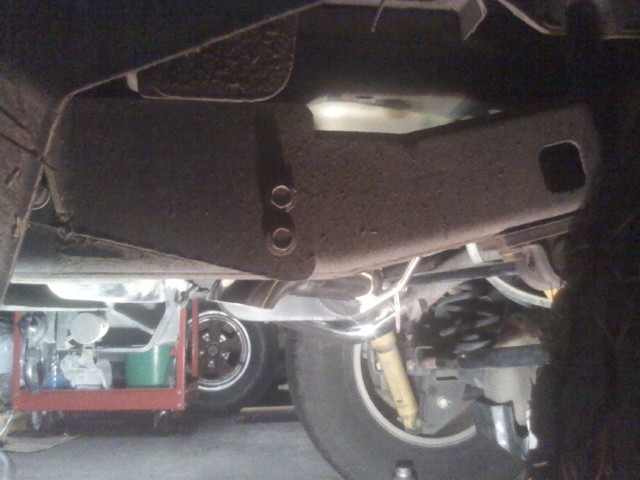

Here's a view from the back -- Note the stainless exhaust tip exiting on the far right, just barely visible.
This side view shows the exhaust tip in the foreground, and the muffler inlet tubing in the background.
