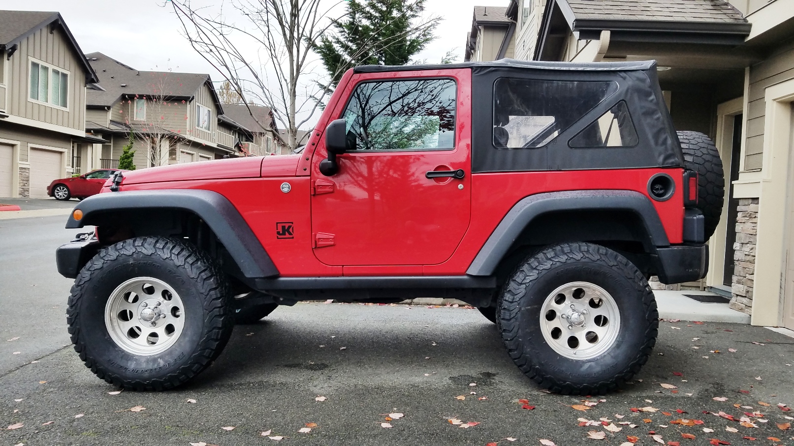

I just installed the OME 2.5 light duty kit last weekend. It's a big difference in the smoothness of the ride over stock. Another huge benefit is the lack of noise. Every little bump I hit with the stock suspension and it was just noisy. Creaking so much it drove me crazy. OME is nice, smooth and quiet. I was able to put 35s on it with ease. I drive it everyday and only go off road 3-4 times a year but all update this again after being on the trail.
A little pricy but a very nice lift kit. Fairly easy to put in too.
I just installed the OME 2.5 light duty kit last weekend. It's a big difference in the smoothness of the ride over stock. Another huge benefit is the lack of noise. Every little bump I hit with the stock suspension and it was just noisy. Creaking so much it drove me crazy. OME is nice, smooth and quiet. I was able to put 35s on it with ease. I drive it everyday and only go off road 3-4 times a year but all update this again after being on the trail. A little pricy but a very nice lift kit. Fairly easy to put in too. <img src="https://www.jk-forum.com/forums/attachment.php?attachmentid=660172"/>
