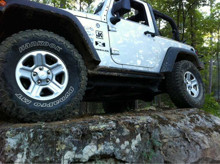

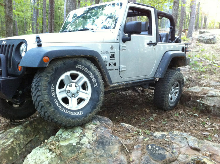

I picked up a set of RK 2.5" springs and a set of shock extenders on here for $150 total. It works great for me as a DD with 33's. I used the extra cash for a front currie antirock. I travel about 50 miles a day with this set up.

so you're just running new springs and adapters? no new bump stops or brake line extentions or anything of that nature?
