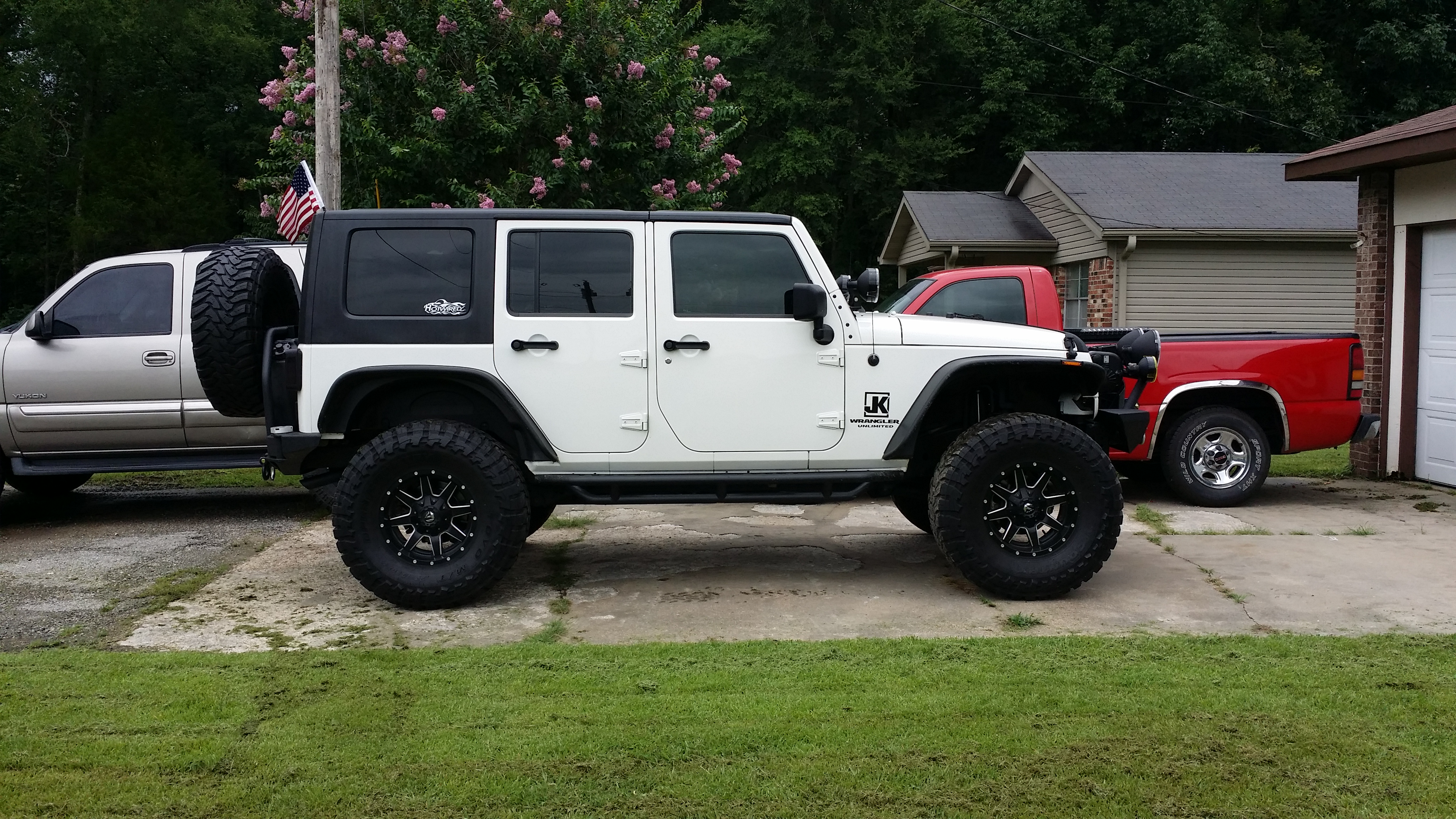

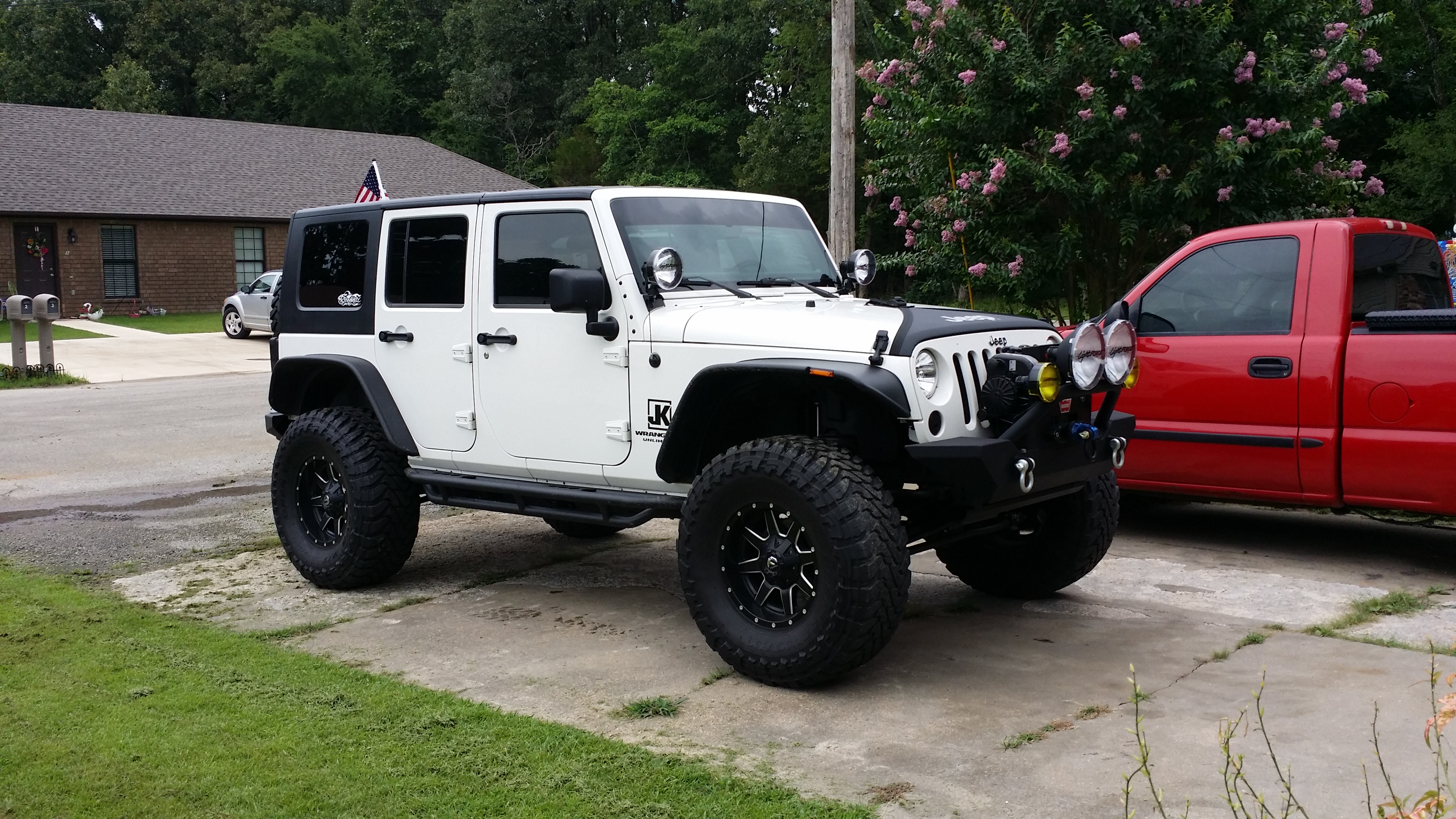

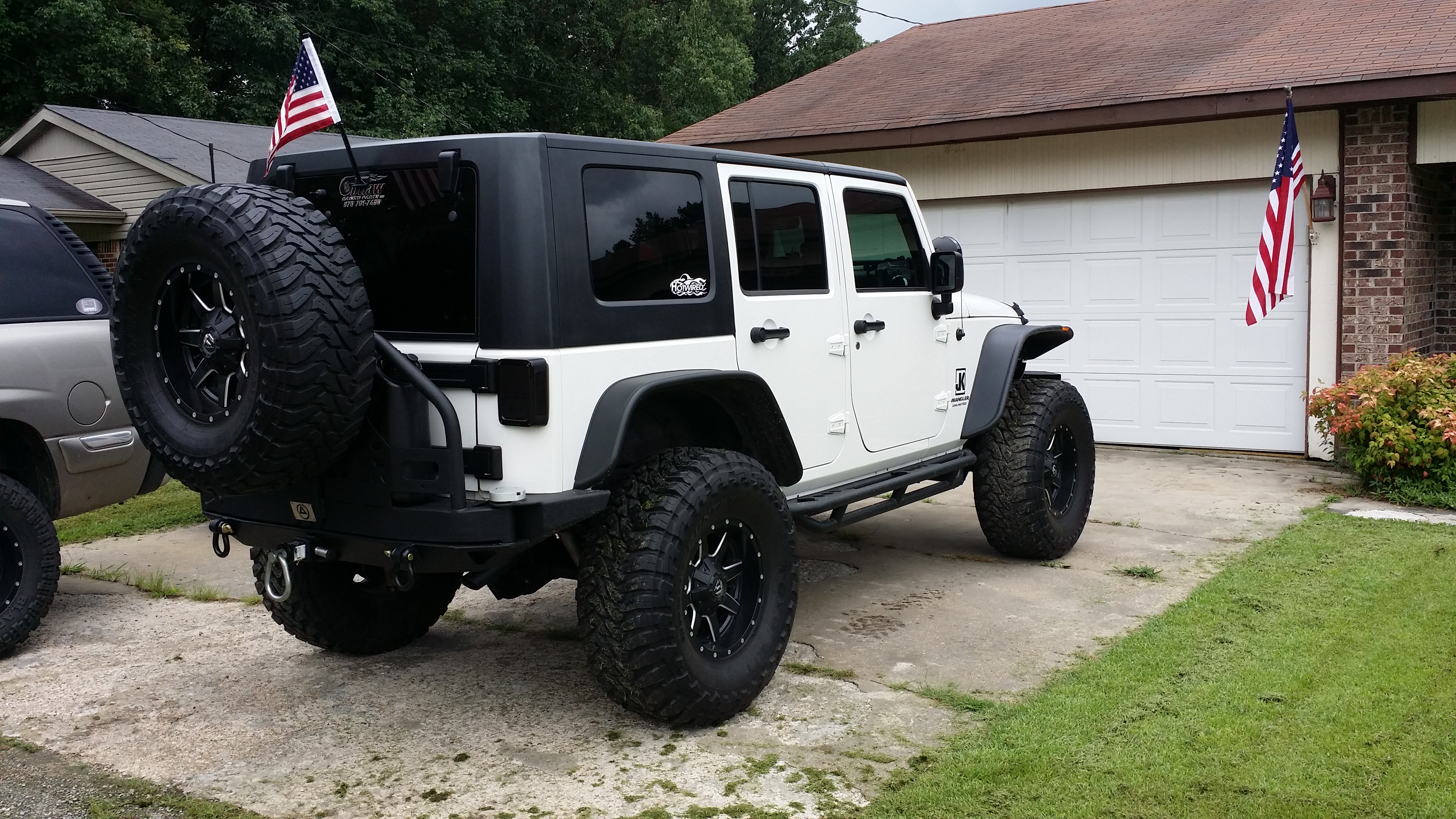

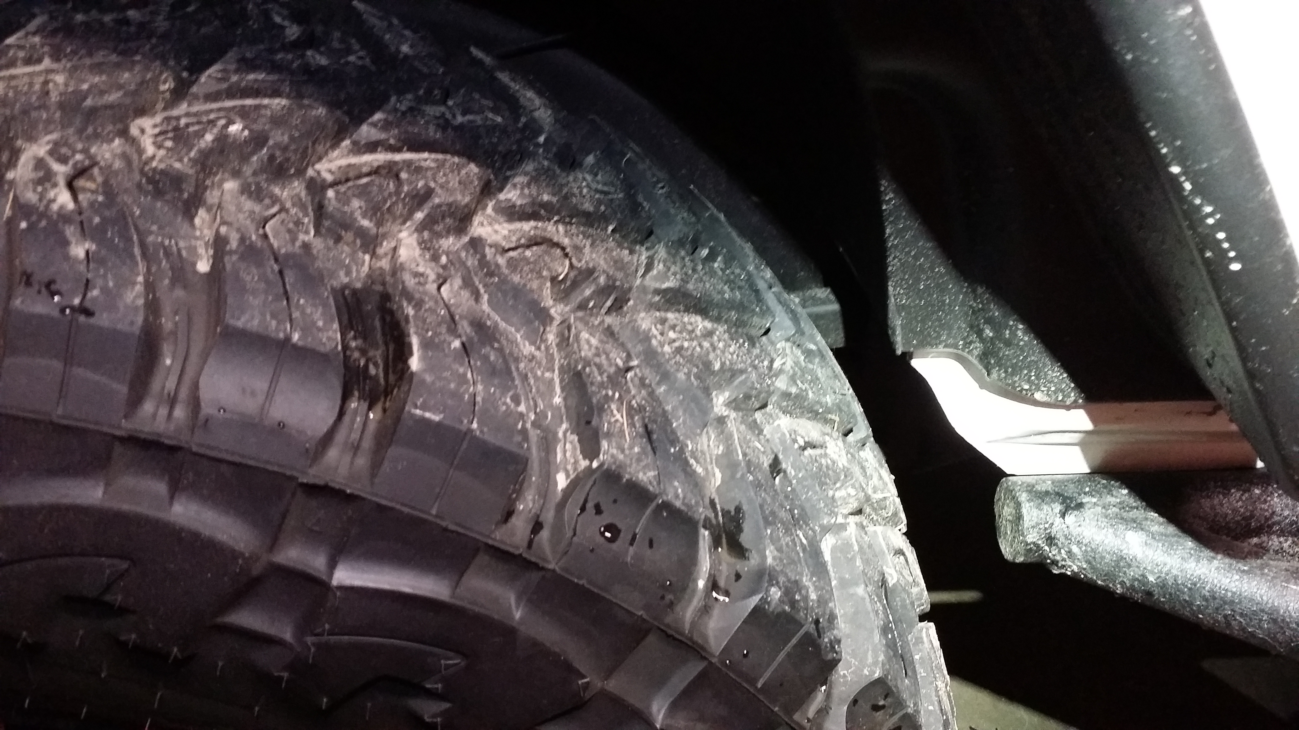

I have a 07 4dr JK with a 3.5 lift and 37 toyos, after adding Smittybilt rear Atlas bumper with tire carrier and 2 full jerry cans, warn recovery kit, Hi-Lift Jack, chains, straps, and subwoofer box with 2 15s in it, my Jk was rubbing the rear inner fenders even with a Bushwacker flat fender kit. Not to mention the extreme body roll in curves do to the added weight, and forget about hooking a trailer up to it. I knew what I needed but nobody makes a airbag kit for a lifted JK. So I called Firestone and after talking with them and measuring my coils they found that Firestone Kit 4151 for a Mercury car had the bags I needed along with all the connectors and hose. I ordered the kit from sdtrucksprings.com for 94.00 shipped and in 2 days I had it. I used the Hi-Lift jack to raise the JK and completely decompress the springs one at a time and in 2 hours I was done. I put 60 PSI of air in each bag and that raised the completely loaded Jk to 1/2in over what it was empty. I took it out for a test drive down a rough road that bottomed my JK out empty much less full and I had zero rubbing, not once, the body roll was gone and it drove as if it were a stock jeep with nothing in it. I could probably lower the air to 45PSI in each bag and be fine, but I like the firm ride at 60PSI. And if I hook my trailer up to it all I have to do is increase my bag pressure to level it back out. Im very impressed with the kit and the quality of the air bags.
