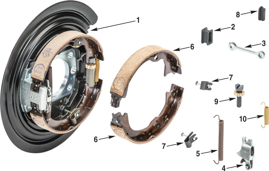

I really need you guys input on how i can really fix my E brake, before i head to Jeepsafari this April, right now if I pull it up its very loose... Heres the following stuff I have already done
1. Replaced the brake shoes, both tires
2. Have adjust the star behind the drum until it wont go any more ( I can only adjust it while the drum disc is half way because if i remove it and adjust it while is off, the drum disc wont go in anymore
3, I have checked behind the parking handle for any adjustment but there no adjustment as i seen on the 2008 jk... Mines 2011 Rubicon
4. *****I have not replaced that brake drums disc yet,,,*****
5. brake hardware hasnt been replaced either

Personally, I'd look at the cable and see if they're stretched after 6 years in service.
never really knew
the jk had a emergency brake . After putting em brake shoes and all , it still never worked as it is supposed to . mine catches on last click after skipping a few notches , if you can count on that even . Never had a vehicle in my life that had such a problem with a emergency brake. just another well known issue with a jk . Not going to loose sleep over it though. Id never trust it with my life though. Mine really never worked right from the date it came from factory. Your best off putting it in gear , shutting engine off , pull the em brake . Before walking in front of the jeep ive found. The em brake shoe kits are a pita as well with all the silly springs and rivets &
adjusting the gear wheel is next to impossible with out removing the wheel over and over again . Seeing its near impossible to adjust from behind the rotor shield access slot w/ hub and wheel on.
