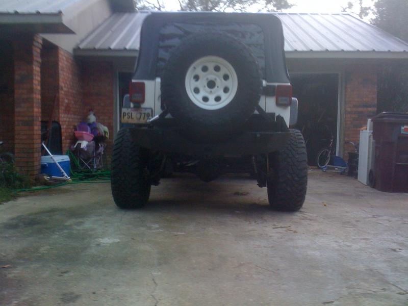

I have been trying to figure out a death wobble issue and noticed that one side sits hire than the other. Long story short I broke my axle housing on the right side so I have had to replace most everything. After measuring from the ground to a spot on the bumper it shows that the side I broke sit about an inch lower than the other. I checked my springs (which are new) to make sure they were seated correctly but no luck. Is the any other way to check if the frame is bent? If it is could that be the cause of the death wobble?

The only way to check a frame is to go to a body shop that has a frame machine. You will never be able to tell with a measuring tape.
Unless you were in a major accident or a roll over, you should not worry about a bent frame.

I was in a off road mishap where i landed on that side. I figured it could have bent it as well. I never noticed it was leaning before all this. Also it is modded with bumpers winch 3'" teraflex lift, ect.

if you have adjustable front swaybar links. make one longer than the other. Usually you will have to adjust the right side longer than the left and the Jeep will become more level.
