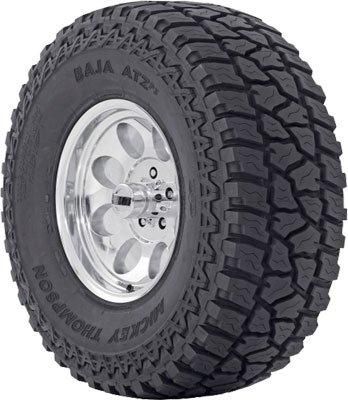

Anyone running these? I think they are relatively new and may have replaced the original baja ATZ. The tread design looks like the 37" version of the duratrac. They only weigh 80 pounds. Would love some info from anyone with experience running these tires regarding road manners, balancing issues, tread ware and sidewall toughness. Seriously considering pulling the trigger on these

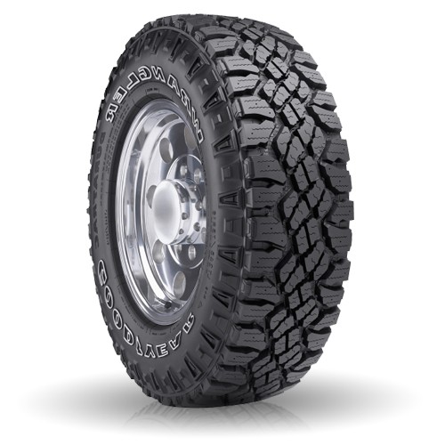

The Duratrac has a highly-offset 2-6-2 tread pattern (tread block count from sidewall to sidewall) with lots of sipes - with its wider-than-typical tread voids, it's a very aggressive all-terrain. The ATZ and ATZ P3 have a typical mud-terrain tire's large tread blocks with a nearly-linear 1-2-1 tread pattern, but they've iven it narrower tread voids and a little bit of siping to make it more like an all-terrain tire.
Large tread blocks are more prone to wear unevenly and "cup" or "feather" and get noisy with sketchy handling than the smaller tread blocks of an all-terrain tire. I'd personally prefer the wide-spaced, smaller tread blocks of the Duratrac to the narrow-spaced, larger tread blocks of the ATZ P3. But if you're shopping for a 37" tire, the Duratrac is automatically off your list. There aren't many all-terrain tires available in the larger sizes - most are mud-terrain tread patterns. I'm glad to see Mickey Thompson and Dick Cepek (Fun Country) coming out with fresh tires in these larger sizes that bridge the gap between A/T's and M/T's.

I don't think they look anything like the Duratrac:
Attachment 481457
