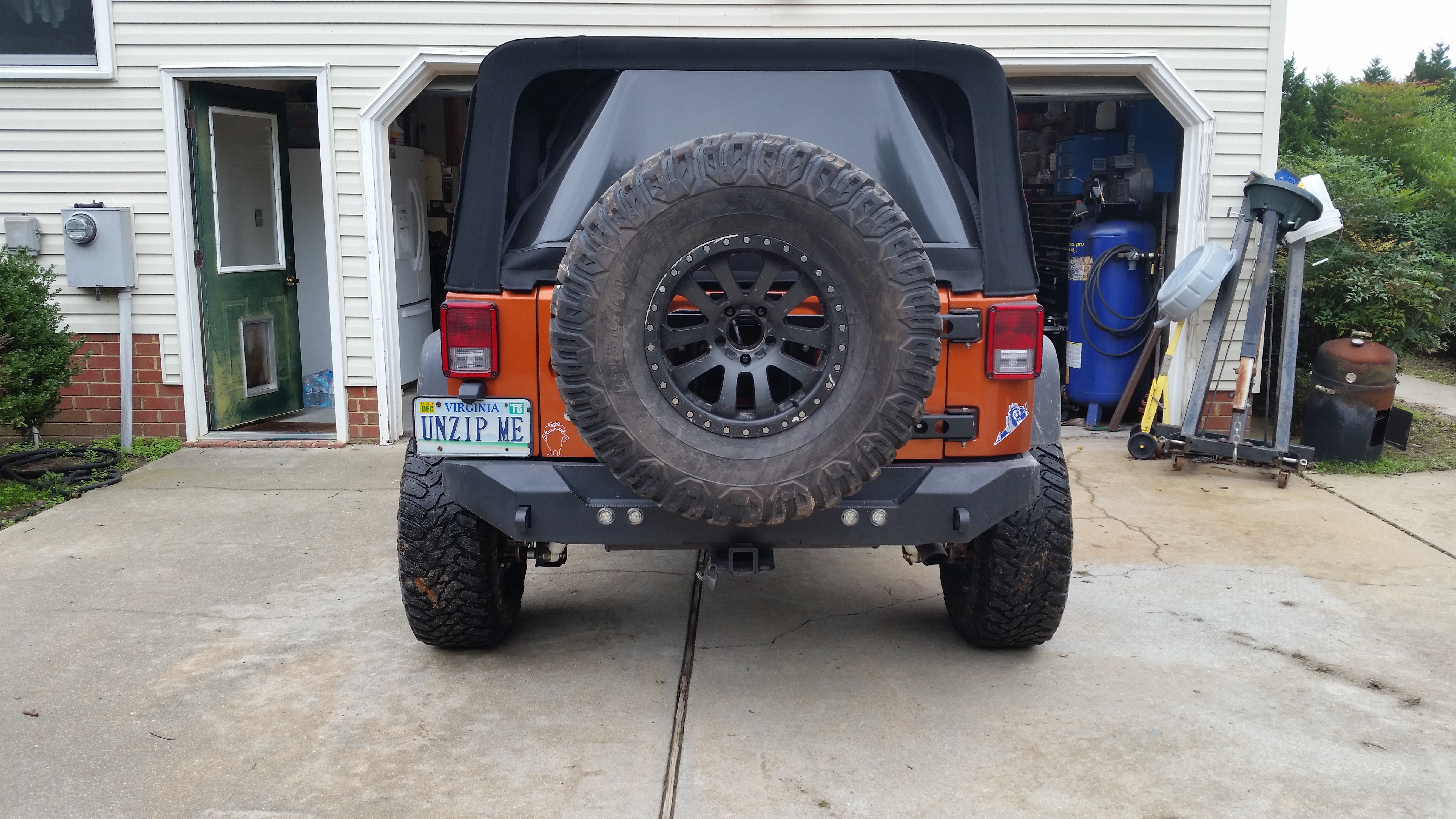

37*13.5" here and the gate wasn't really much heavier than the stock setup. When you look at adding 110lbs to the gate, it's really not too heavy.
Attachment 666457
Attachment 666457
