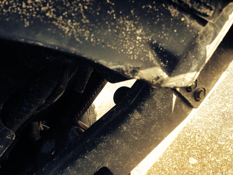

Small question for you peeps running 37s
I have a 2011 2 DR, 2.5" TF coil lift, gave me alittle over 2.5" of lift gainz and flat fenders
Upgrading to 37" nittos, currently running 35s that measure out to be 33.5.. The rear tire well between the pinch seam and the tire itself I only have a few inches before it makes contacts with my 35s. My concern is my 37s will rub on it. I've trimmed it a few inches when I put on my PSC rock rails.
If I get upper and lower control arms to recenter the tire back, will I need a new drive shaft? I've read Planman's 37s thread cant seem to understand If I do or not, I have plenty of space for them to fit If I can just move the axle back a few inches
Thanks.
Thanks.

Thanks for your input! I'm confused on if I need a drive shaft if I use the lower and upper control arms to push axle back a little bit, I'll upload some pictures later. I don't think I do but I'm probably wrong.

i have the same lift on a 2 door running true 37s and did not need to push the axle back. im still running stock rear arms. i did however do more trimming to my pinch seam
