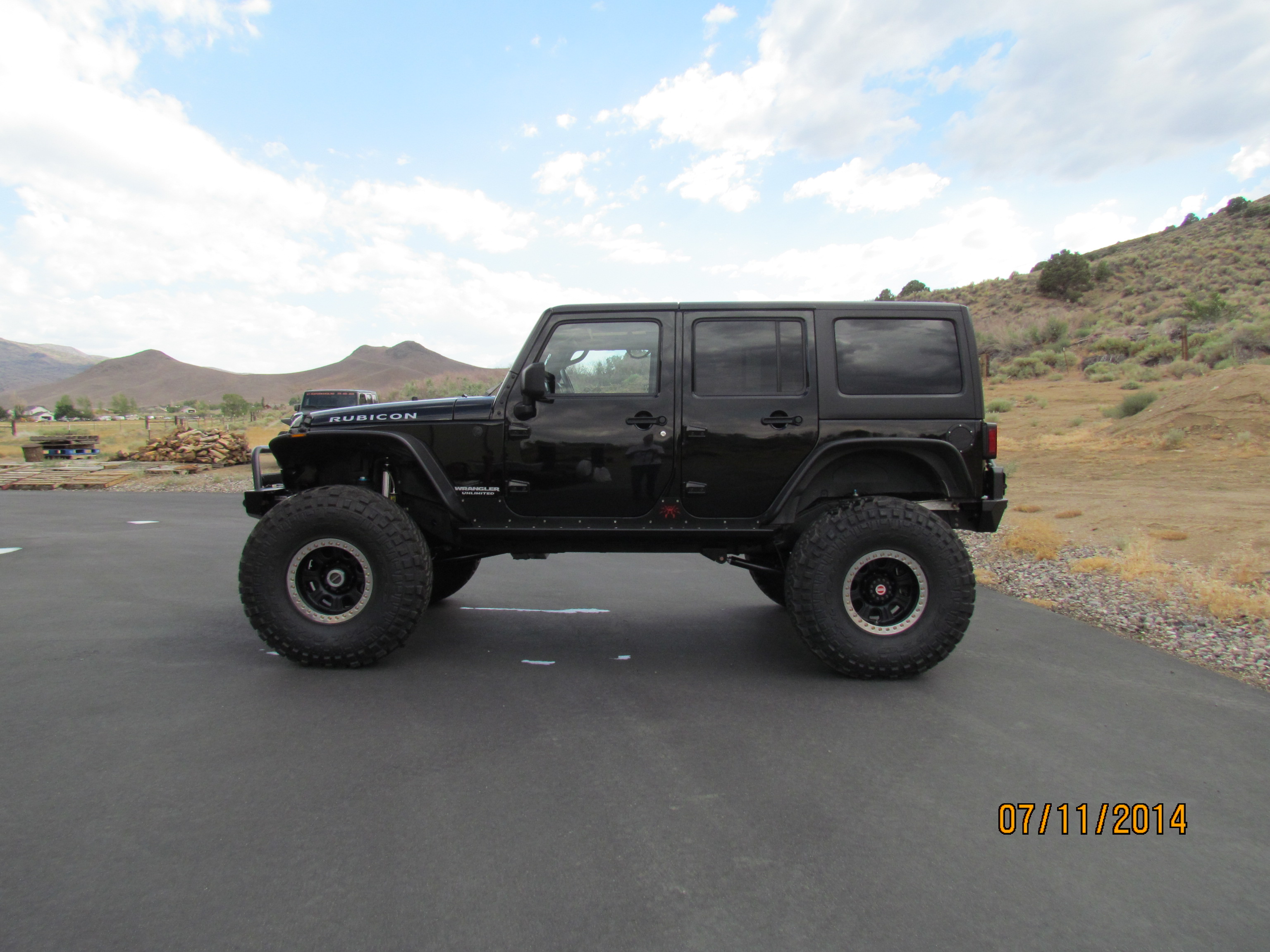

I've got a RK pro 3 link LA kit. lowers front are 34" rears are 35".
Joints and arms can take a beating..

Can you post some shots of the arms from the side of the jeep?

I modded the front lower frame brackets so I could fully flex the 11" shocks. My ride height is 5"
Side-hills great, street manors are better than stock.
I have a Currie 1" rear and a ORO front sway bar.
Weigh's 6400 lbs as it sits.
In the process of doing my LS-6l80e swap.
C/O-Bypass all 4 corners , keeping the front 3 link but will go to a double tringulated 4 link in the rear.
