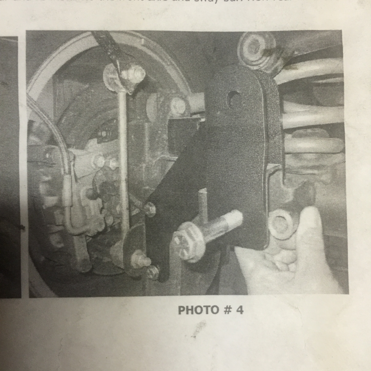

I'm on the last part my installing my lift, and I can't figure out how to install this rear track bar bracket!
Anyone got a pic?
I think I was sent the wrong part!
Anyone got a pic?
Super Moderator
I just removed one and the bracket went over the existing bracket and bolted into the shock mount, the vertical flat there. It realistically should only fit one way.
