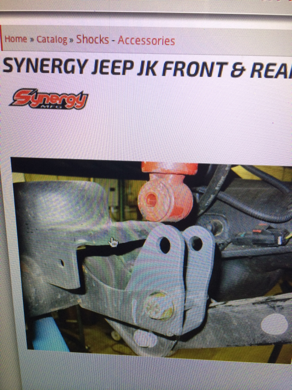

So it looks like synergy front relocation brackets, and metalcloak rear brackets used together is the best way to go about this. They both move the lower shock mount up about 2 inches.
Synergy's bolt in to the stock mounts up front, and Metalcloak's bolt in to the rear brackets after you drill holes for the new bracket, then you can cut off 3-4inches of the lower portion of the rear shock mounts gaining ground clearance for crawling.
Will definitely be going this route when I lift in order to reuse the stock shocks for a while.
My next question, if anyone sees this, is can I use the metalcloak outboard shock relocation brackets on top of the synergy brackets up front? Can't really tell by looking. If I welded the synergy bracket in then bolted the metalcloak. The outboard relocation turns the eyelet to allow sway during articulation instead of binding and possible frame contact.

Unless synergy came out with something new their shock relocation brackets for the front simply move the shock out at the axle side. They don't raise them. The metalcloak or nemesis front brackets do raise the mount at the axle side but only by an inch or less.
I guess they are a new product then.
They move them up 2 inches or so, They don't appear to. rotate the eyelet or move the shock outward to clear the frame like the Metalcloak front lower "outboard" brackets do. That's why I was wondering about using the Metalcloak outboard brackets on top of the Synergy "relocation" brackets up front, in order to raise the lower shock mount and also move it outward and rotate the eyelet for clearance with 2.0s and to prevent binding.
