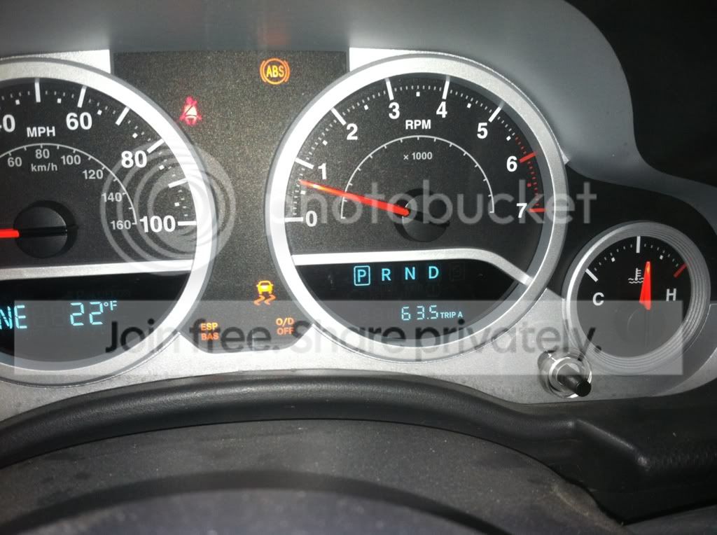

Had the dash lights come on, too. As it turned out, the battery was dying, which can trigger the light gremlins. The stock battery died after only two years, but now I run a Walmart AGM battery which constantly holds 14 plus volts. The AGM batteries are the best.
I have a Sears Diehard Platinum AGM, which is less than a year old. So I highly doubt it's the battery. I've read many who have had the 3 lights come on, but there seems to be quite a few different reasons others have diagnosed as to why they are coming on. Another I read is similar to what you described with the battery in that the battery terminal needed to be replaced or tightened.
See here:
UPDATED: Fixing the ?Dashboard Christmas Tree? in Jeeps | Off-road Vegan
I'm going to check my battery clamps, since that could be it since I disconnected the battery to do the BBK install. However, others have said the 3 lights could be due to a faulty wheel speed sensors as well. Which when I did the BBK install I had to disconnect the front driver's side speed sensor and then reconnect, so I guess that could be another possible cause. So there seems to be many different diagnostics tied to the 3 dash lights coming on. Before and after they come on, I notice my brakes seem to slip like there's air in the line. It all seems like a shot in the dark with this 3 dash light problem. I was thinking to start with having someone starscan bleed the brakes for me, to eliminate that as one of the causes.
These are the 3 lights I see coming on. (minus the O/D off light)
I typically take my car into Belle Tire, since they're open on weekends and that's the reason I was wondering if the starscan was a dealer only option since I rather have them do it on a weekend day rather than having to take off of work to go to a dealer and pay top dollar.
Was curious how much it would cost for the dealer to do it though.

I have a Sears Diehard Platinum AGM, which is less than a year old. So I highly doubt it's the battery. I've read many who have had the 3 lights come on, but there seems to be quite a few different reasons others have diagnosed the reasons as to why they are coming on. Another I read is similar to what you described with the battery in that the battery terminal needed to be replaced or tightened. See here: UPDATED: Fixing the ?Dashboard Christmas Tree? in Jeeps | Off-road Vegan I'm going to check my battery clamps, since that could be it since I disconnected the battery to do the BBK install. However, others have said the 3 lights could be due to a faulty wheel speed sensors as well. Which when I did the BBK install I had to disconnect the front driver's side speed sensor and then reconnect, so I guess that could be another possible cause. So there seems to be many different diagnostics tied to the 3 dash lights coming on. Before and after they come on, I notice my brakes seem to slip like there's air in the line. It all seems like a shot in the dark with this 3 dash light problem. I was thinking to start with having someone starscan bleed the brakes for me, to eliminate that as one of the causes. I typically take my car into Belle Tire, since they're open on weekends and that's the reason I was wondering if the starscan was a dealer only option since I rather have them do it on a weekend day rather than having to take off of work to go to a dealer and pay top dollar. Was curious how much it would cost for the dealer to do it though.
Oh yes...makes sense...could be the ABS (speed sensor) cable is nicked/damaged.
