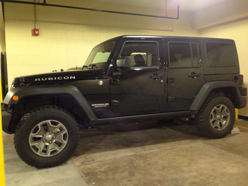

I just put 33" DuraTracs on factory 17" rims with no lift. I get a little tire rub from left tire turning right on the sway bar. I plan on putting 1.5" hub centric wheel spacers and 1" spring spacers on the front for now. Then I think I'll do a 2.5" spring lift with new shocks next year.

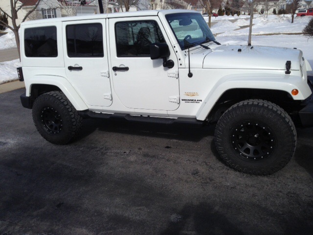

I still rubbed when I had 33" Nitto 's on a Teraflex level kit at full flex. Simple fix, while your springs are out, drill a hole in the bottom of the spring perch, do the same with a hockey puck, bolt it is, wham, cheap easy bump stop extension.
