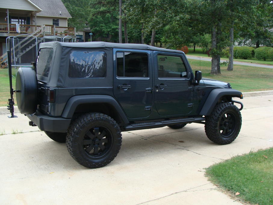

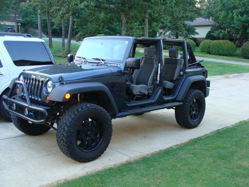

I run a 35/12.50/20
Peopl can say what they want about a 20 inch rim but I have more sidewall than any 33 inch tire on a smaller rim . I love my setup and it rides great
Well. no arguement on the nice looking 20s there pal. But this guy wants to know what width the rims need to be to fit a 33x12.50. What width are yours?
