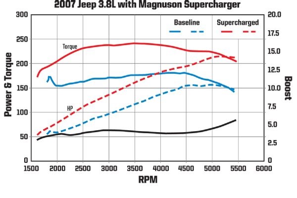

anyways, little tweaks here and there wont net you lots of power. if you want power skip spending money on all the little tricks and just go big.
Attachment 637157
Attachment 637157
