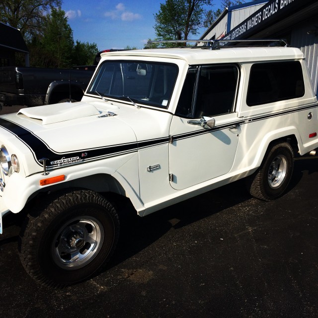

Going in to restore a vehicle is a hard choice. You can go full numbers matching, taking years and years of work. You could also do the resto-mod, where much of the equipment matches, but things like the engine and drivetrain receive upgrades or updates, which makes it more fun, if also a bit less correct. This 1971 Jeepster Commando fits in with the latter with parts that make it more powerful, fun and “safe to drive.” Let’s take a look and see what makes it worth $35,000, as priced on Just Jeepers.

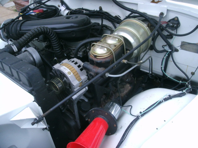

This particular Commando is owned by Just Jeepsters, who know these Jeeps inside and out, but aren’t above making changes. For this build, the body was removed from the frame to begin its restoration and modification journey. Under the hood, where the Hurricane I4 or a Dauntless V6 resided, now sits a General Motors 4.3-liter V6. This is actually an advantage as the 4.3 makes more power without excessively doing so, and the bellhousing bolt pattern is the same as the Chevy V8. This also means it can reuse the Turbo 400 transmission and Dana 20 transfercase. Though, it also uses the Dana 27 in the front, and it does have the 44 in the rear.

Part of the safety upgrades are the front disc brakes, replacing the original drums, and power assist. You also get 30×9.50 BF Goodrich Tires on original Jeep 15-inch oval slotted wheels. Inside you get high-back bucket seats while you listen to the 4-speaker JVC stereo. You also get a new Grant steering wheel to hold on to and a new roll bar to protect you.
This resto-mod is also a tribute to the Hurst Jeepster, the rarest version of the Jeepster Commando, and in doing so it comes with many period and package correct parts. The shifter is the Hurst Dual Gate for the Turbo 400 that you shift in harmony with the Dixco tachometer. The hood is the Hurst Performance version with a hoodscoop along with badging in and around the Jeepster. However, it does not feature the Hurst stripes and instead uses the SC1 stripe kit that matches the C101 and gives it good character.
