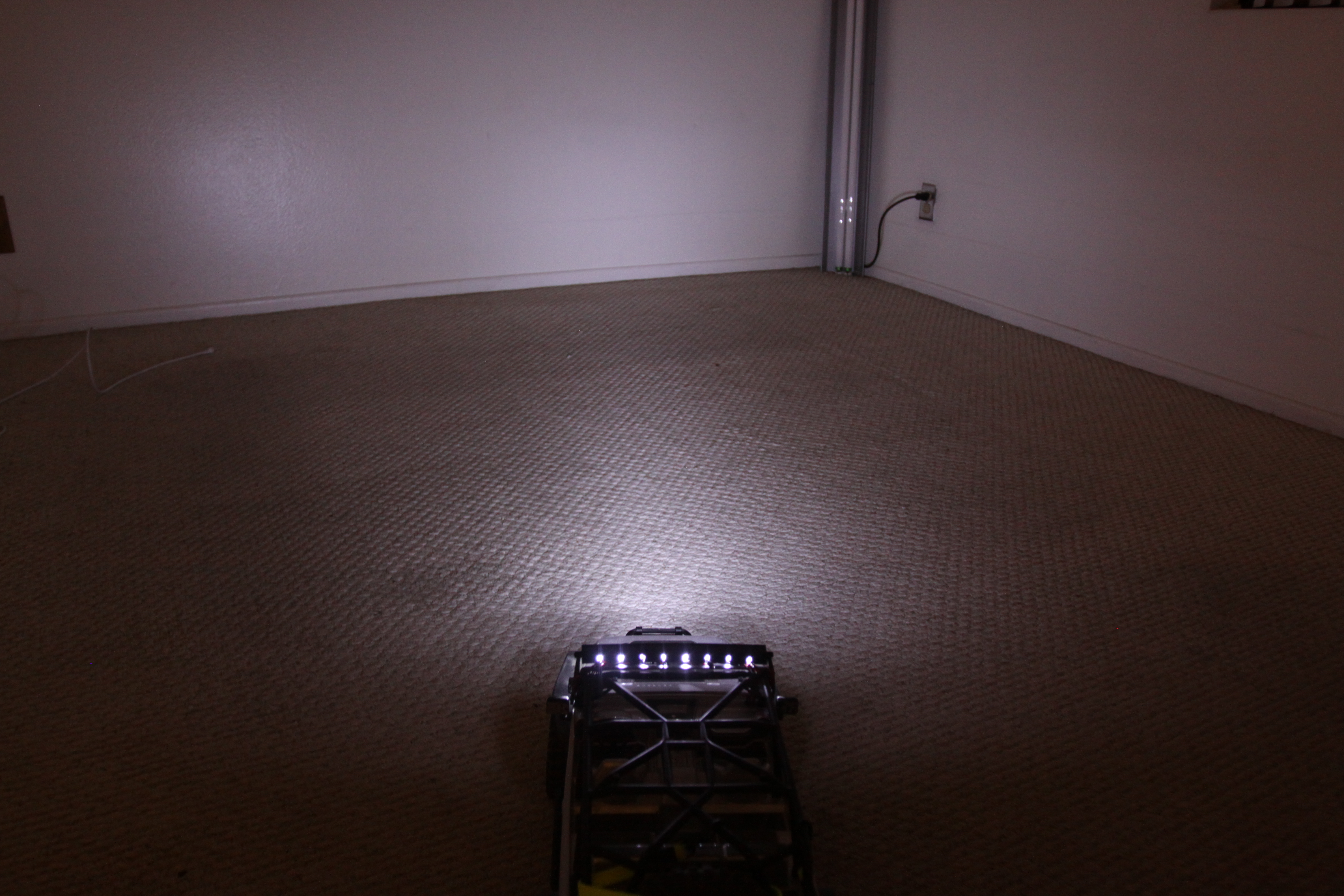

Finally, we added some lights for nighttime crawling action. The front set are universal Rigid Light Bars that use 5mm LEDs. In the rear I added two red LEDs to the back bumper and a blue LED on one of the D-ring brackets using some screws, a spare rod end, and some washers. The lights are powered by two nine-volt batteries that I ran in parallel to get single nine-volt power but two nine-volt batteries worth of run time.
IMG_7114
The LEDs I simply sourced from EBay. They are based on the GT Power RC LED Car Kit, but are an off brand. There are a few issues I’ll still have to work out for wiring, but will work for now.
