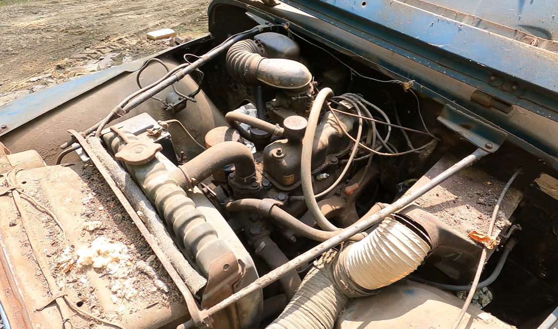

The engine won’t turn so Stetar begins the process of brining the CJ-5 barn find back to life by removing the spark plugs. Plug number two looks a little nasty but the others look like they were brand new and never run on. Perhaps someone made a go at getting this running recently and got in over their heads. It is not a great sign for Stetar. He squirts some Kroil penetrating oil into the cylinder head where the plugs were removed to hopefully loosen things up a bit. It might work but Stetar is already considering his options. “Worst come to worst, I do have a 4-cylinder VW diesel engine.” Says Stetar. Oh no! Please don’t do that!
The Kroil was allowed to sit for about a month and a half and do its job. However, the early reviews are not good. The engine still will not budge an inch. He even removes the starter and puts a prybar right on the flywheel, but the thing just will not turn. Next a borescope is inserted into the cylinders to get a closer look at what the issue might be. The results are not encouraging. “This number two cylinder looks bad. It’s so bad that after a month and a half of sitting with the Kroil in the cylinder, the Kroil is still around the rings. It hasn’t all dropped down into the oil pan.” Says Stetar. Before pulling the head, he tries one more trick. He pours some rust remover right into that problem cylinder in the hope that will free it up.

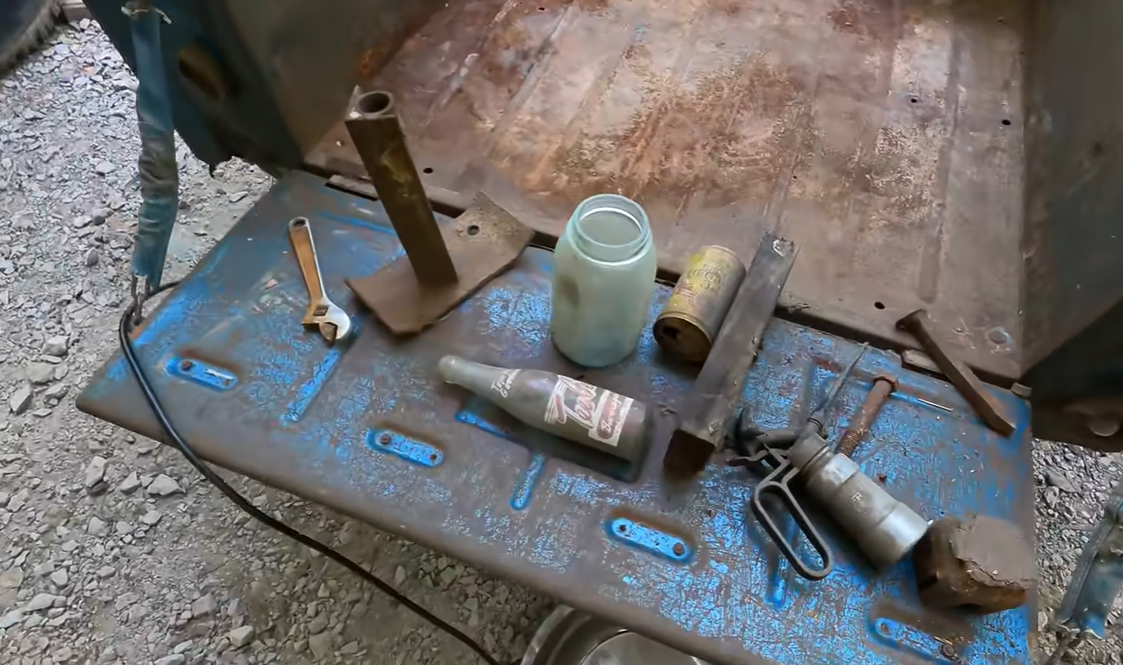

While he waits for the rust remover to do its job Stetar goes about cleaning up the old CJ-5 a bit. It turns out to be quite an interesting little treasure hunt. He finds several old-school pull tabs from beer cans scattered about the Jeep. However, there are bigger items than just those. He discovers an old beer can, a Tee Gee glass beverage bottle, a mason bottle and an 8-inch crescent wrench. There are a few other little odds and ends in there as well. Not a bad little score. But so much for intermission, time to get back to the main event.

The rust remover has been soaking for about a day and a half. Stetar hooks a wrench up to the crank snout and gives it a tug. “It moved!” Shouts Stetar. That did the trick the engine is now able to turn over. It is not ready to take on the Rubicon Trail just yet, but this is a major milestone toward reviving this Jeep. Next up is trying to start the engine. The starter is reconnected, and the key is turned. Nothing. He puts the spark plugs back and cleans the points in the distributor. He then pours a bit of 2-cycle gas mixture directly into the carb and jumps it from the starter. After a couple attempts the old Jeep CJ-5 roars to life! Well, more like sputters to life, but still, after sitting so long that is great news.
