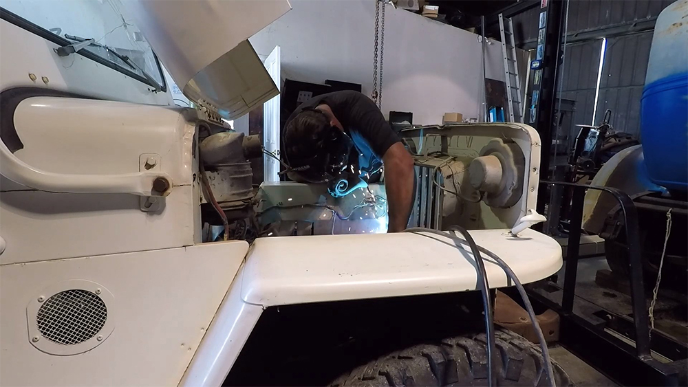

Welding a cracked subframe on a 1960 Jeep Willys CJ3-B
Step one finds James welding up a crack in the Jeep’s subframe while he has easy access to it. It’s always refreshing to see these kinds of projects done in pure DIY form.
