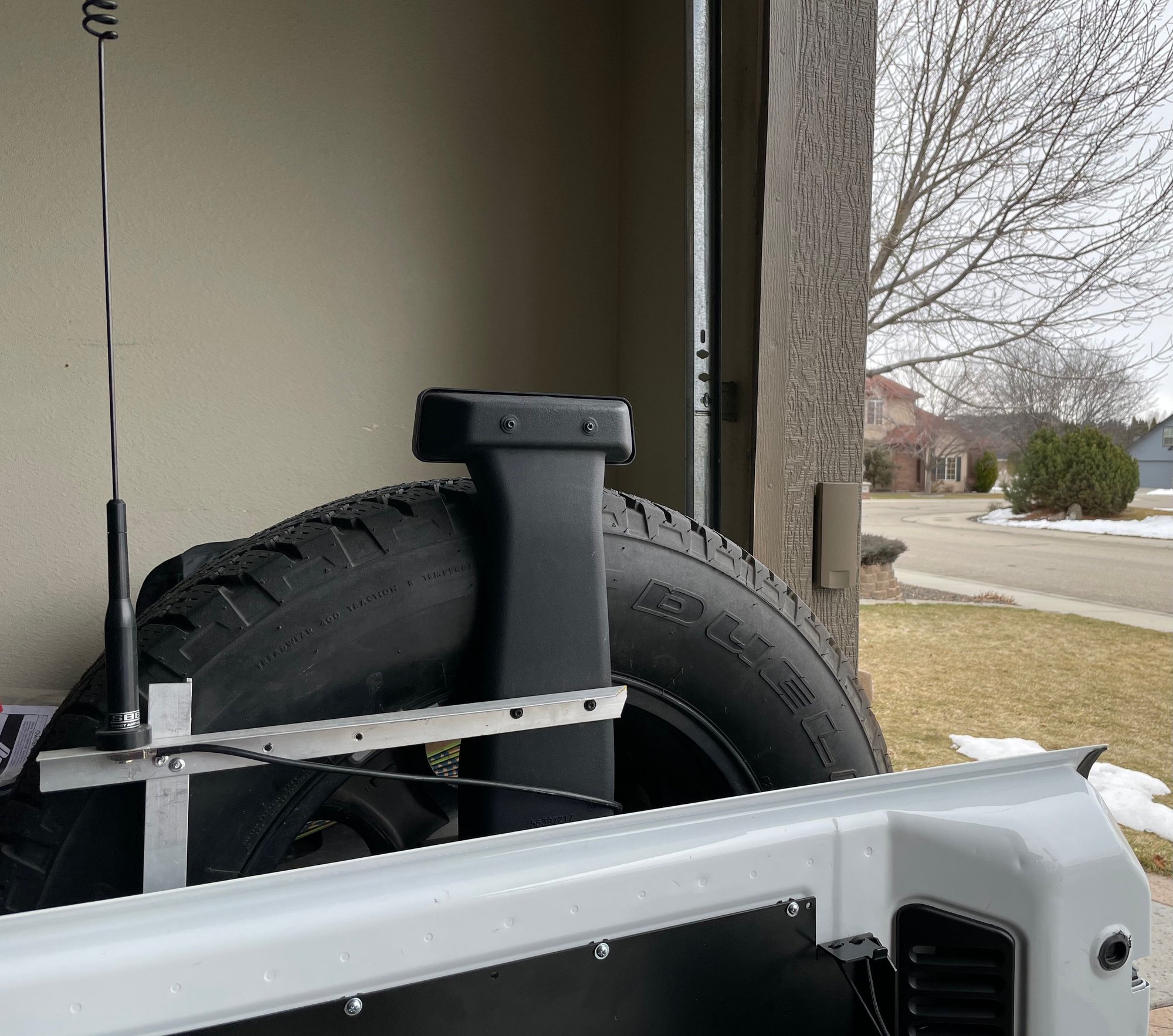

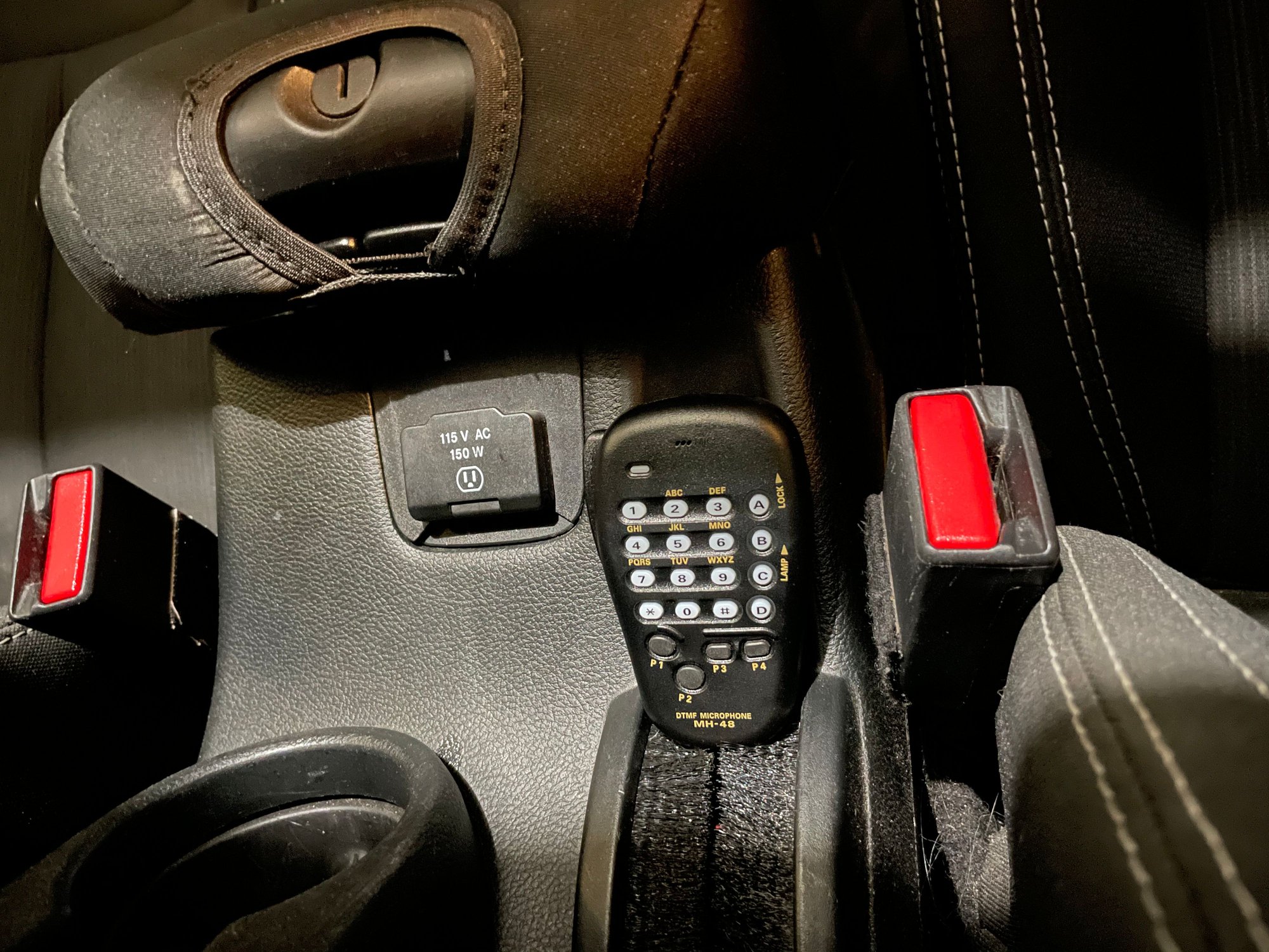

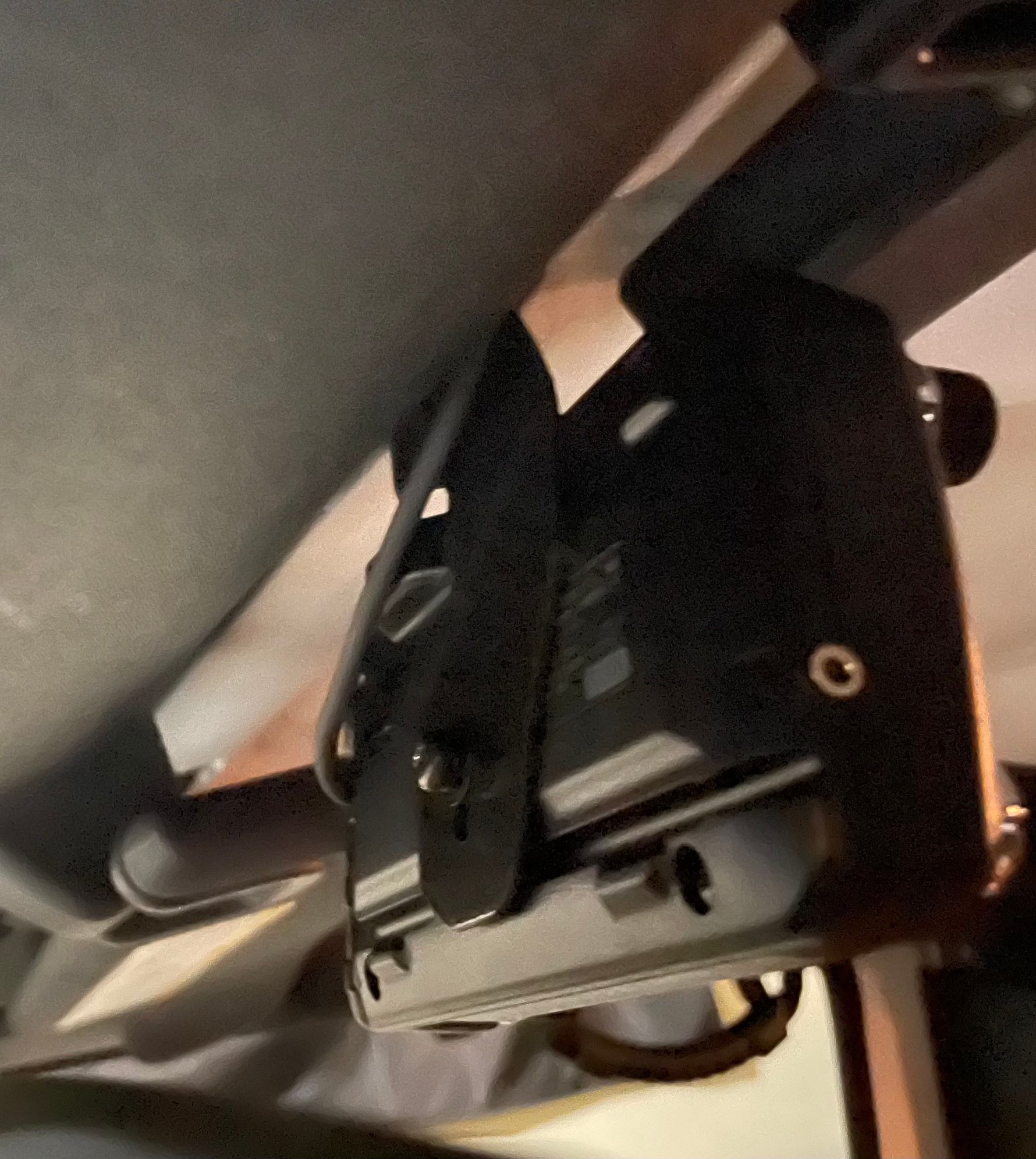

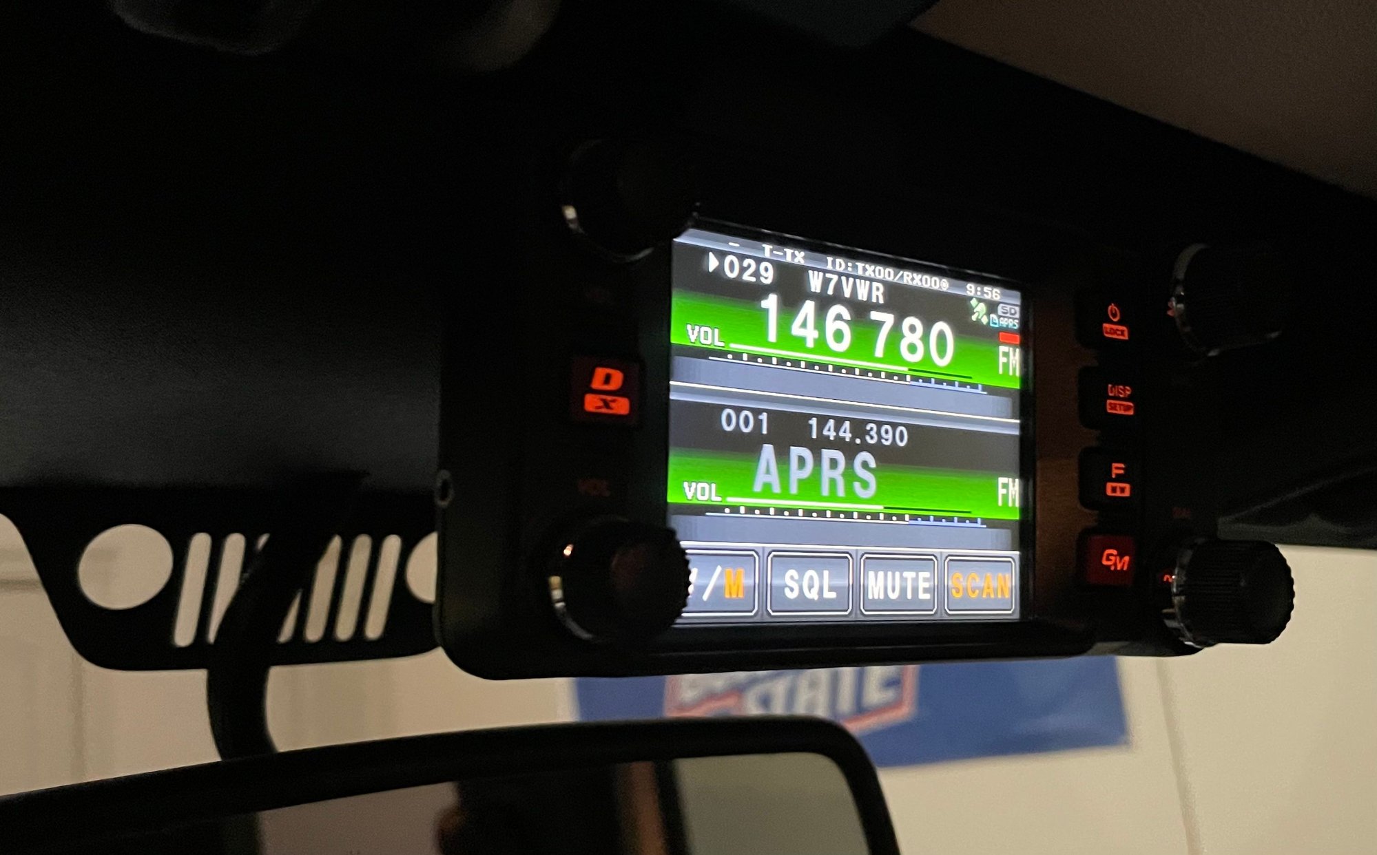

I have installed my Yaesu FTM-400 in the JK. I put the face above the mirror. I designed and built bracket bracket that goes under the plastic and screws to the frame of the windshield. The body is below the seat in the microphone next to the driver. I plan to install a speaker above the driver on the rollbar. Attach the antenna to the rear brake light mount. It shook quite a bit so I had to do a vertical support as well. Anyone else have ideas on the antenna mount?
Any ideas on how to improve?

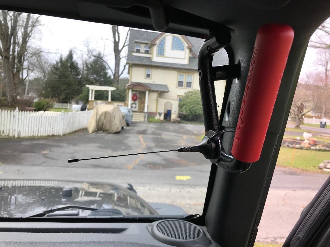

Originally Posted by wgw
Looks good... nice and clean. How are the SWR that close to the windshield?

Pretty much flat 1:1 across the band

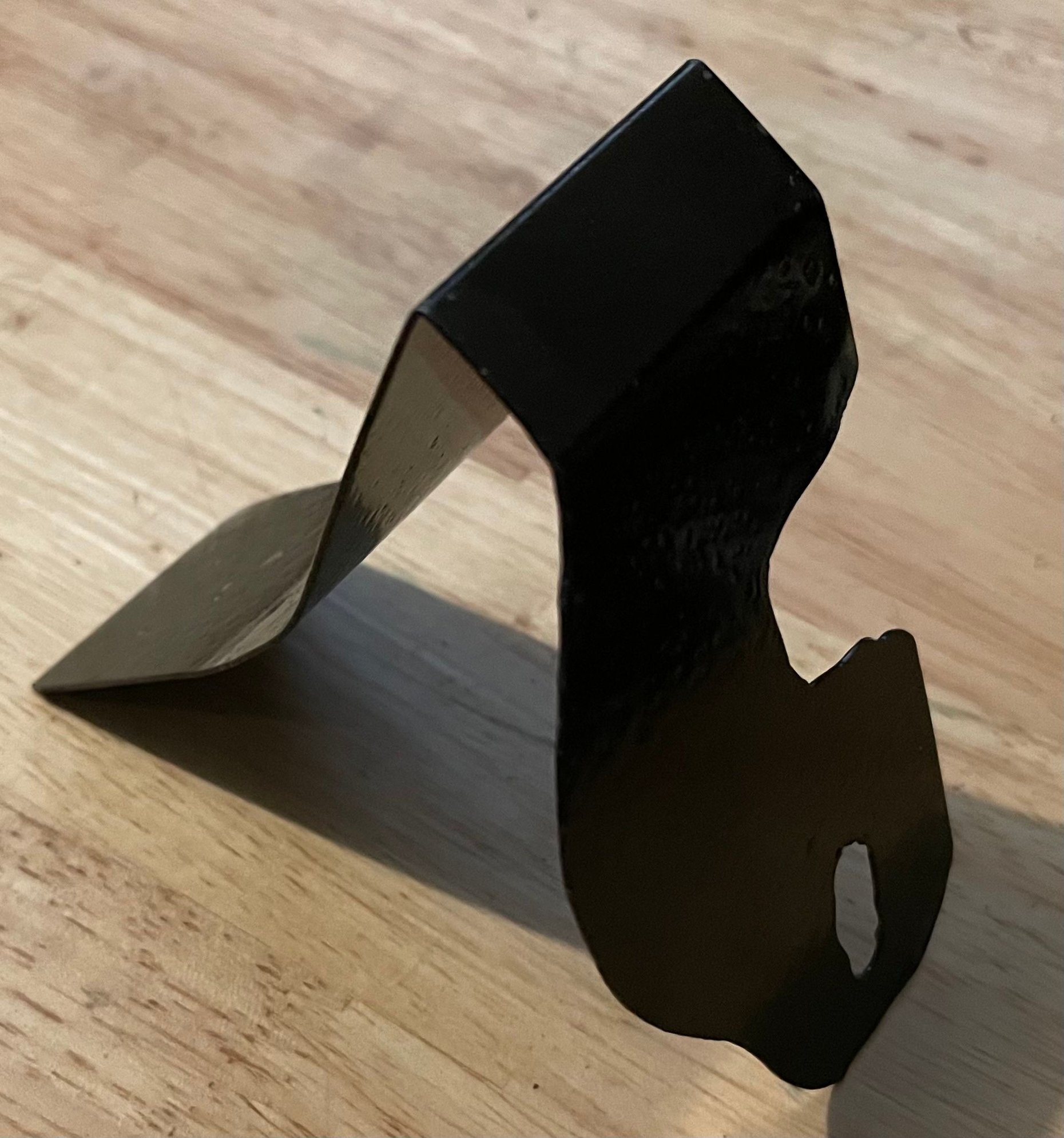

https://mid.factoryoutletstore.com/c...SABEgJ_4vD_BwE
its only 32" high..sticks up maybe 3" over my soft top, and is coil mounted....
