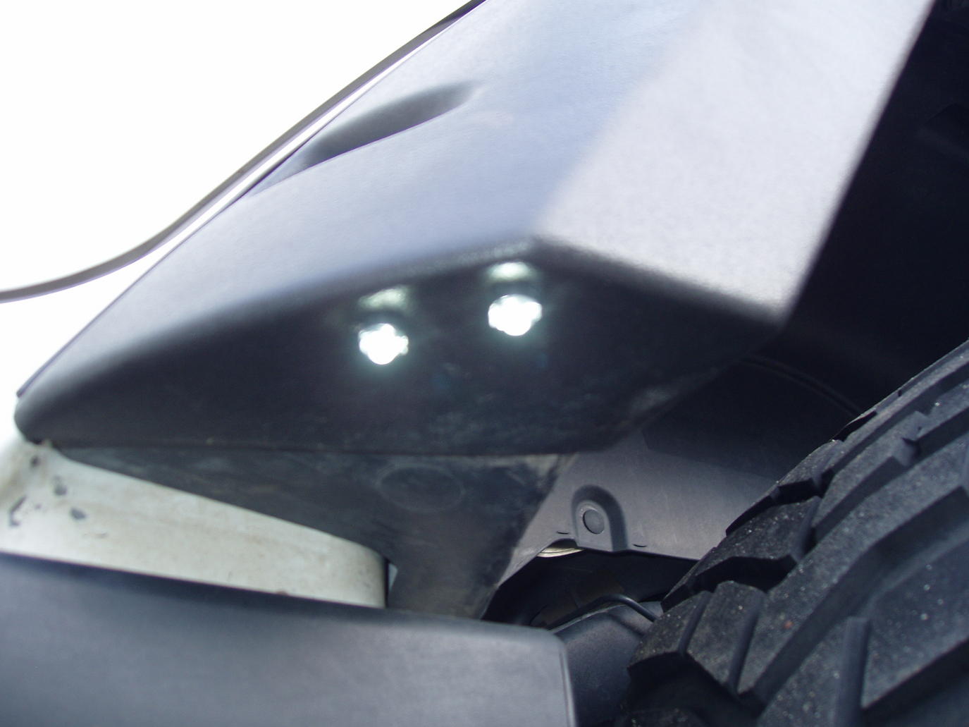

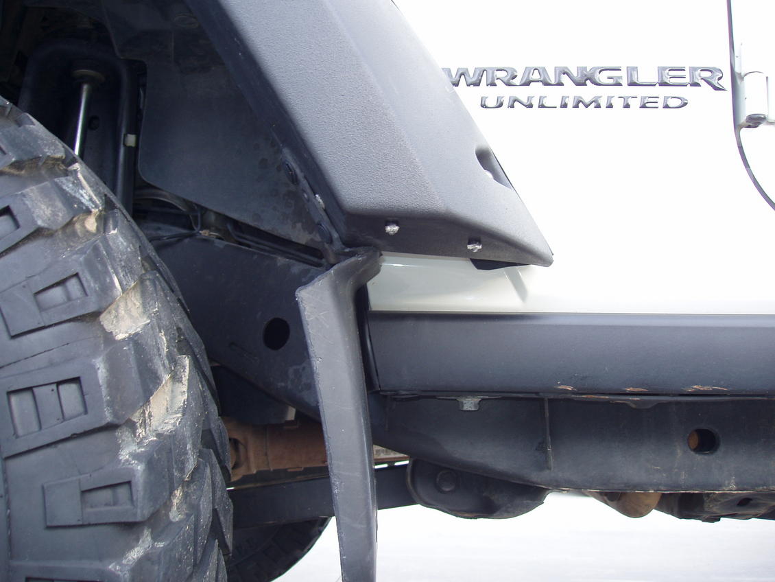

Here's some shots during the day for location placement. Each led is pointed straight down..
Note you don't have to have 2 in each location. I just did for redundancy and extra brightness.

No I DO NOT WORK FOR THEM! I just like helping fellow jeepers with cost efficient solutions. You can see from my other posts on HID installs and the "Rescue" badge it would be easy to to think I do work for these companies....but I don't. I just do a lot of cut copy and pasting from the original site for descriptions of the products.
Well if you mount these flush you will have a VERY hard time replacing them if you break one. The way I currently have them mounted now you simply pop them out and replace it and pop a new one in. No glue or clips at all. Just drill a 11\32 hole instead of a 3\8 hole as described. Then you'll get a nice snug fit. (I know this because I did smash one on a branch on one of our clubs last runs)
As for seeing them in the daytime you would never notice them until I pointed them out to you. And if your standing anywhere around the JK you'll never know they are there...
