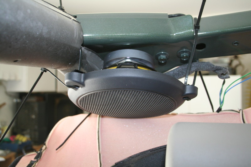

Pulled the soundbar off today. My rear passengers are always hitting their head on it. Totally different view from the rear now. Did a little tinkering and I think I can remount the speakers in the sport bar behind the rear seat. Will update soon.

I removed the sportbar covering and put the speakers in against the plate in the intersection of the sportbar in the rear of my 4 door. I zip-tied each corner with the speaker cover in place and around each point of the bar. Then it was just a matter of splicing and re-routing the wiring, trimming the foam spacers and replacing the cover. Now I need to mount grab handles in place where the soundbar was.
