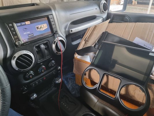

- the screen came pre-attached to the middle part
and there was also another dash part that covers the speedometer.
I've read many reviews about people having gap issues with these kind of units, but to my surprise I had none. I think probably due to the fact that I took my time to pry off all the plastic tabs that are meant for (right side driver seat).

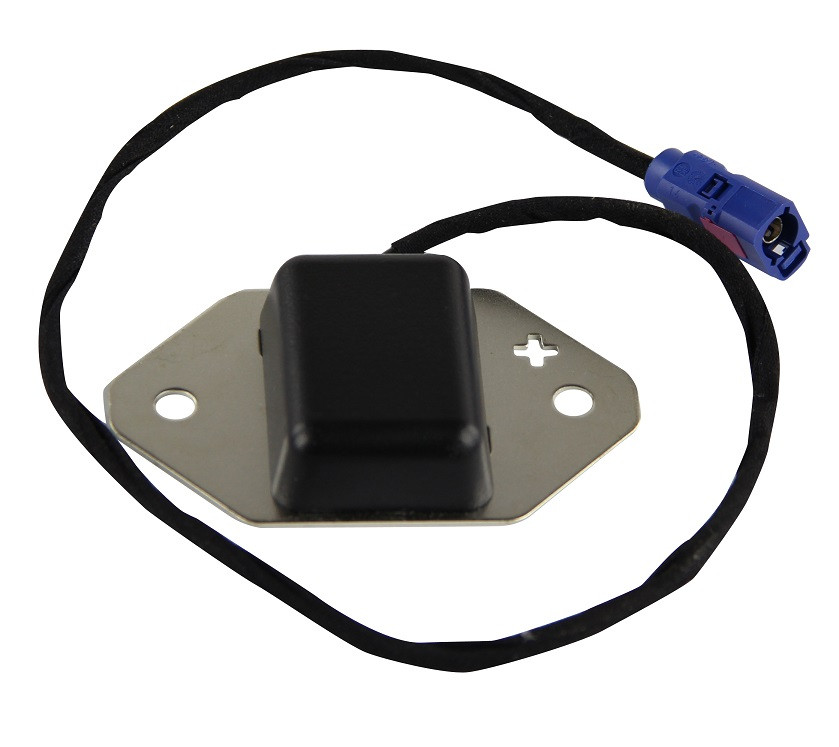

Installation: Sadly it came with no instructions other than a picture of the backside where everything plugs in. but It's just like any other android headunit (if you youtube them), I replaced the stock GPS box with the new one that came with the unit (the OEM one looked like this) I just unscrewed the black box from the metal plate and installed the new antenna there.
to make sure it actually sat flush with the new panels I took my time prying off the plastic tabs and flushing them out.

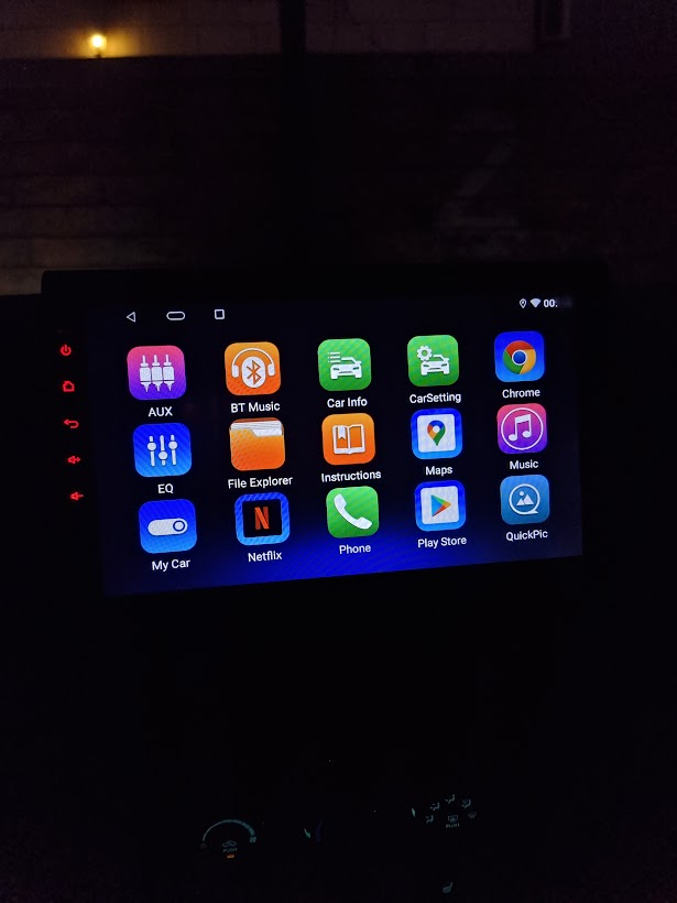

First impressions: the unit takes few seconds to boot up the first time but after that its just instant. speedwise, It's not slow but its not as blazing fast as current gen smartphones. once everything was updated and setup, it seemed pretty much responsive (doesnt lag when you pull up the keyboard or when you switch inbetween spotify/google maps etc). However the stock launcher is meh at best, I installed Vivid launcher and that made it much more asthetically pleasing (it is a bit heavy on the system though).
Canbus wise: you do keep your steering wheel controls (vol up/down - next track etc.) and you also have the ability to program them (e.g. I programmed a mute button)
