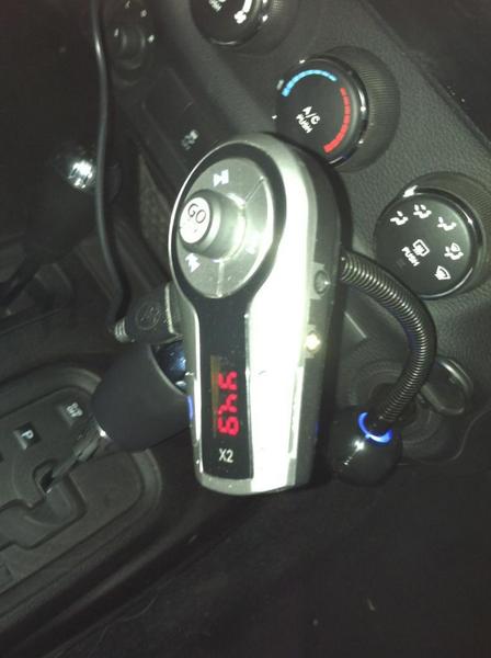

I use this thing called a go groove x2. I think it $20 at target. It plugs in to the cigarette outlet, can charge my phone, ( charging in pic ) and has bluetooth with a built in mic for phone calls. The signal can be sent through a built in fm modulator ( operating like this in picture ) but its a little staticy at high volume. Or you can run a cord ( like the one in the picture in the aux ) from it to your auxillary input. ( which makes a very clear signal ) You could use it completely wirelessly. I don't know what the buttons do. I think I read once the u-connect kit is something ridiculous like $300-$400.

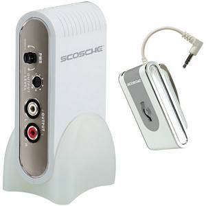

Scosche iPod bluetooth kit, picked it up on clearance years back.
Came with a transmitter for the iPod, receiver for the radio.
I put the receiver inside the dash. Lord only knows what happened to the transmitter.
Wire exits dash between radio faceplate and bezel, can unplug jack as desired.
Used it a few times, but not much of an MP3 guy, unless to cram more songs on one CD/DVD than the original CDs.
Also, Bluetooth eats my phone's battery like a fat chick at a Chinese buffet.
It's discoverable the first 30 seconds or so after the key is turned on and paired painlessly.
(the smaller box is the receiver)
