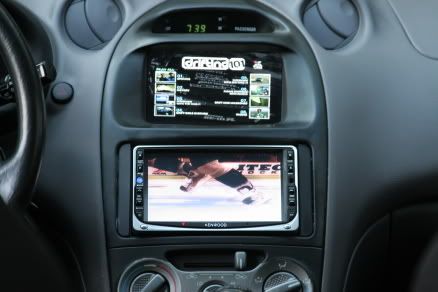

I had one in my celica for a while. I actually found it a pain in the ass. On a 5 min drive to get radio would take like 5 mins for the comp to get up and running. then having to actually look at it to change it was just as bad. My way to solve this problem was by doing this.
you can't really run two screens in a jeep and I don't trust the thieves so I would never do this.
