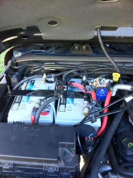

I went with 2 platinums auto batteries. I still think maybe I should have gone with the marines. (both have same cold cranking amps)

Old Dec 24, 2011 | 01:40 PM
SlowJK's Avatar
Posts: 52
From: Clayton, NC
Attachment 253950
You have the best setup for the money. I would stick to auto batteries, the platinum have amazing no charge time on them. As they are re=branded Odyssey batteries one of the best on the market right now. Stay the hell away from optima.
