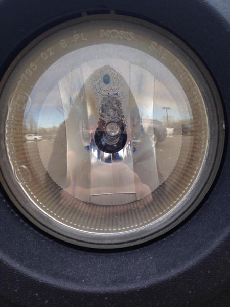

I drive a 2014 4 door and I myself installed HID fog lights 8k.. When I had it up on the lift the other day I noticed the inside of the housing was starting to melt. Anyone else have this probelm? If so what did you do? Is it ok to just leave it? Lol

That is happening because HID bulbs do not belong in stock housing. Not only is it illegal but as you can see potentially catch on fire. Spend some money and get some Rigid duallys and the brackets to mount to factory fog location

I had ddm HIDs in my old jeep with 55w it did that but with the 35w it didn't but of course I didn't leave them on all the time just on back roads and open interstate.

Damn brother! do you need a step stool to get down from that soap box?! Lol. It is only LEGAL under these circumstances...
1. Any. There are no laws governing bulb type in an auxiliary light.
Your statement is true when discussing headlights. To a certain extent. It is not illegal to put the bulb in a stock housing if it has been properly upgraded to project the light as in a manner to not obstruct the view from oncoming traffic. (As in a projector retrofit). Just blasting off like you are says you are tired of being blinded by dickweeds with blue HIDs in non retrofitted housings. I am too. But, I also HAVE HIDs in my Jeep. On all front facing lights. They are, however, installed legally and have DOT approved retrofits to make them so. As to WHY the bulb melted the lens? My guess is that the bulb is a high Kelvin bulb with lots of mercury and less salts in the ignition area of the bulb. These types of cheap blue (high Kelvin) bulbs run substantially hotter than a quality double encapsulated UV resistant HID bulb. In fact, a high quality bulb that is double encapsulated will run cooler to the touch than a halogen.

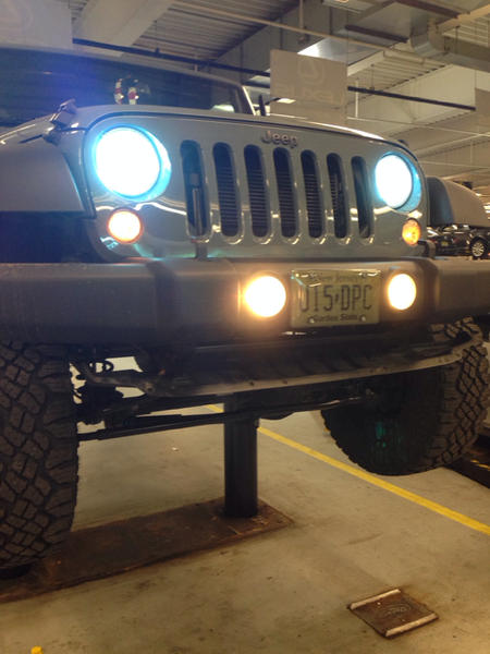

Replaced my HIDs blues with a yellow bulb that hopefully won't melt my housing any further! Thanks!

This may be an option. I replaced my crappy stock plastic housing with some Pilot 3 inch fogs. They will fit in the stock mounting brackets with a little modding. However, the Pilots have a glass lense and a metal housing so they may hold up to the heat better. I ordered them off of Amazon for around $35. hope this helps.
