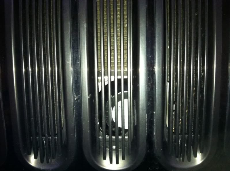

my speaker is mounted behind my grill. for my siren i have the SVP remote siren its awesome!

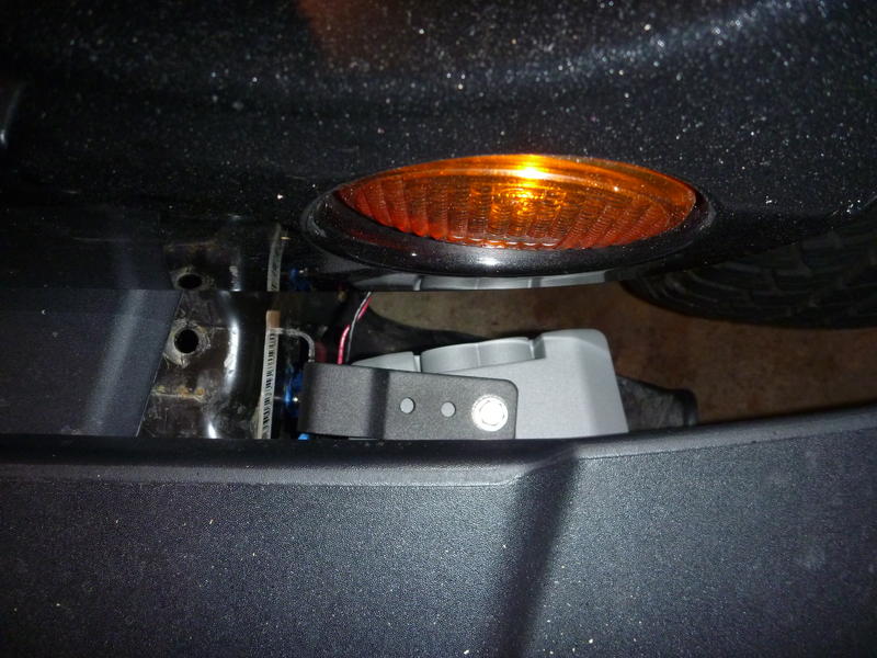

Well I finally got my siren speaker mounted. It is the Galls brand low-profile 100W speaker. I used the bracket it came with, just had to get a few stainless bolts to mount it to the chassis. It is on the drivers side tucked up behind the bumper. All the wires are pulled away from any moving chassis components.
I might have to paint it black to hide it better though.

11JK,
Can you even hear that thing behind the bumper like that?
Old Jan 26, 2012 | 03:56 AM
  #56
11JK's Avatar
Posts: 37
From: Detroit, Michigan
Actually its quite loud. There is a pretty large gap between the bumper and the face of the speaker.
Im not a sound engineer, but I think the speaker throws the sound into the curve of the bumper then it just escapes out the top bottom and side.
Plus its basically out in the open, so there are less other components to absorb the energy vs. if I had it mounted under the hood.
