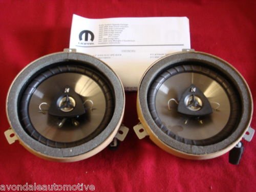

Amazon has the OEM Jeep Kickers from a dealer in NC. $65/set + shipping. Just got mine yesterday after I was considering some others from Crutchfield. From all accounts here, these are a great upgrade for the stock system (and cheap to boot).

you came here for some advice, so, here's some advice. Mopar is the sales channel, but these are made by Kicker (well, by a factory in China like everything else). These are a direct fit and more importantly, they are 2ohm impedance and designed to work off the factory amplifier.
100% chance the ones you're looking at won't sound better than the ones I posted but it's your rig to outfit.

I replaced my dash and sound bar speakers with the Kicker (part# 77kick10) upgrades from the dealer. I decided to go that route for the fact that they just plugged right in to the factory wiring (no splicing). I noticed a big difference in sound quality as soon as I turned them on.

I ordered the same ones PGT is showing. Same dealer. Got here in 3 days. Went to craft store and bought some poly-fill. Sound bar was easy, passenger side a little more difficult, and the drivers side a pain in the a$$. I have a 2009 Wrangler Unlimited and the speakers plugged right in. They sound much better now.
