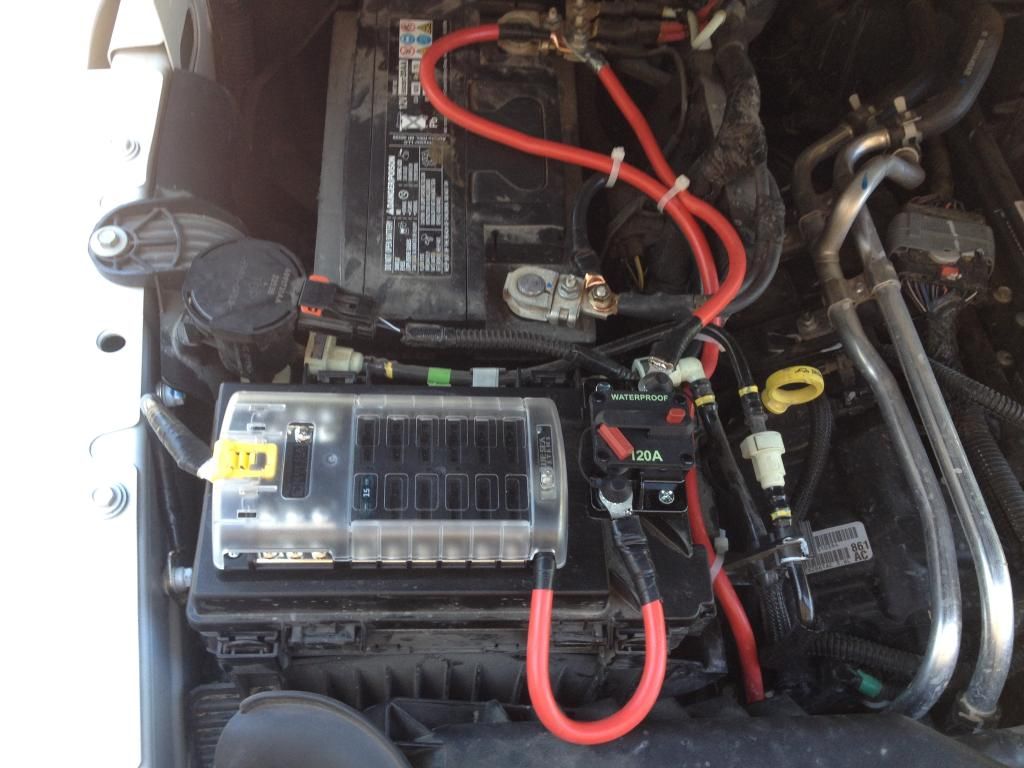

Finally, I addressed power distribution with a Blue Sea Systems DC sub panel and a 125A waterproof breaker.
