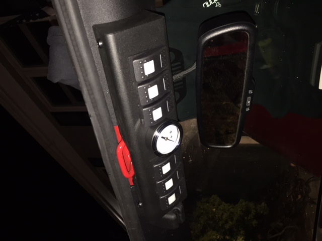

i recently was the winner of a LED bar giveaway from black oak, and when that showed up at my house i figured i should properly wire in the compressor and get the new toy installed as well which necessitated the install of the SPOD, and holy cow it was a breeze to put in and i wish i had done it sooner. The temporary fuse tap underhood switch on my compressor was starting to scare me, and having a proper dedicated switch now is great.
The most difficult part was routing the cable behind the top of the interior trim without pinching my fingers. total install time was about 3 beers( 2 hours) and after getting it in place, total time to wire up the compressor and 20" grille mounted bar was about 5 minutes per accessory.
overall im really excited that adding accessories moving forward will be less of a puzzle, and that i wont have to worry about draining my battery from accidently leaving the compressor on or if my kid hits a switch and leaves lights on.

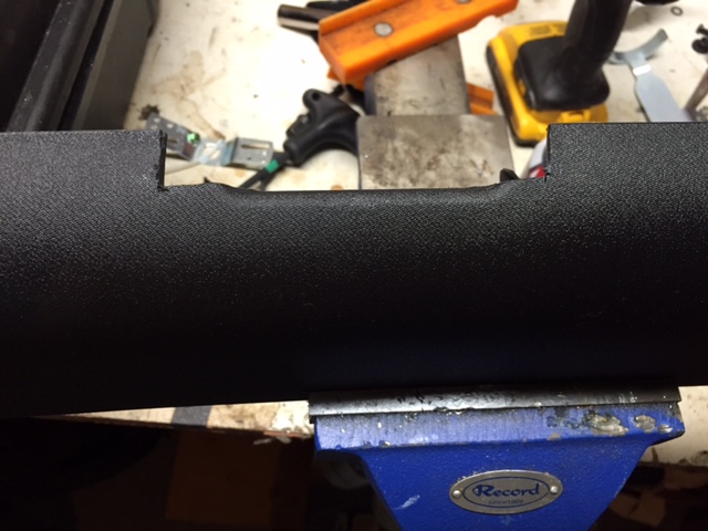

the top trim piece needs to be cut to clear the bracket, I ended up having to cut a bit wider than i thought. two quick zips with the dremel and it was done.

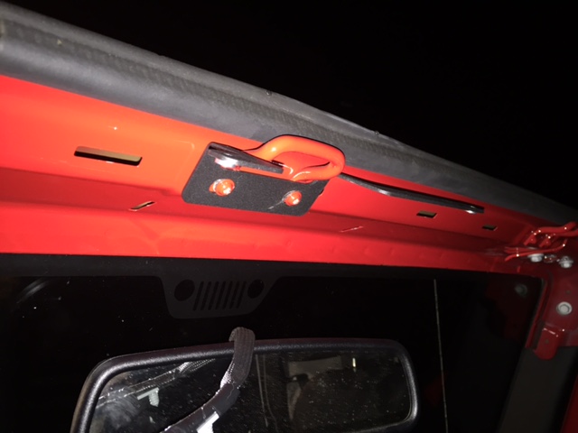

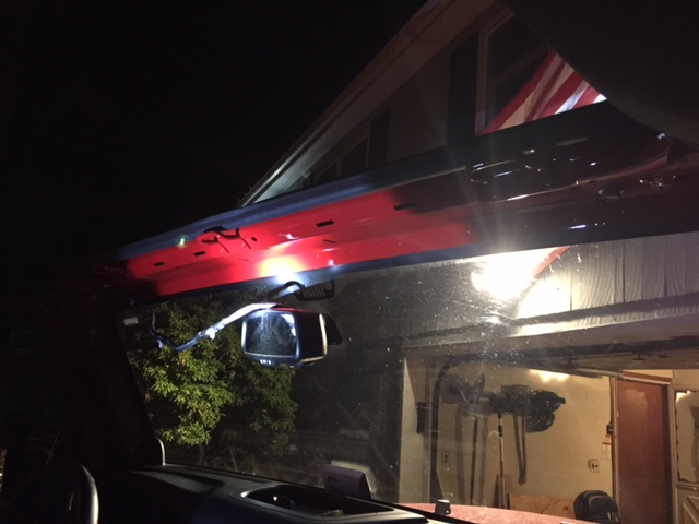

interior trim removal was a snap(literally) once you take off the ends, the center piece pulls down and is held in place with those little metal trim clips, dont worry, your not going to break it.
when i installed the bracket back in, i did one side at a time. Not really necessary but in the dark, i didnt want to lose screws.
