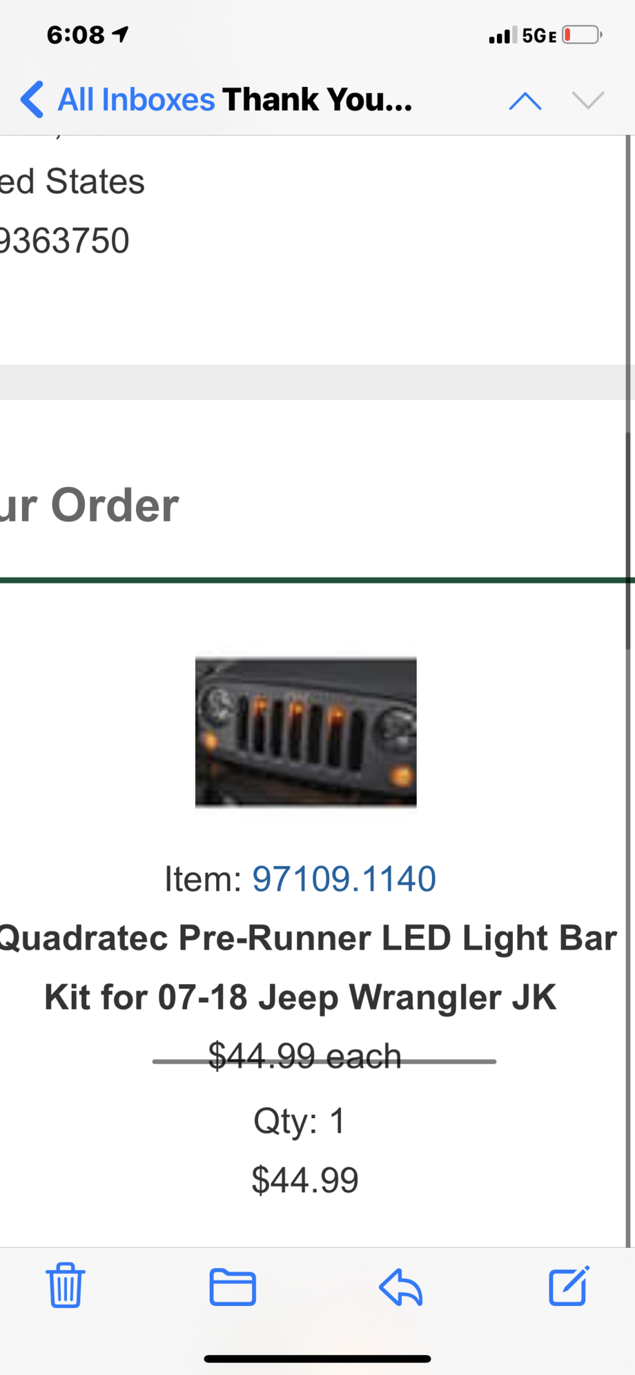

Hi! I purchased quadratecs pre runner light bar kit for a wrangler jk. I mounted it and then realized I can’t access the side marker bulb because I have bushwhacker flat fender flares. Any ideas on how to connect the light bar to any of the amber lights? Thank you!

You most likely cannot parallel connect lightbars to any other system like you want to as the TIPM will sned a fault code out due to higher loads on that circuit. You need a switch pod system connected to the battery with remote switching inside the Jeep that will not be part of the TIPM system. Or you can power from the battery use a fuse and switch direct then to the light bar. Place fuse near the battery.
