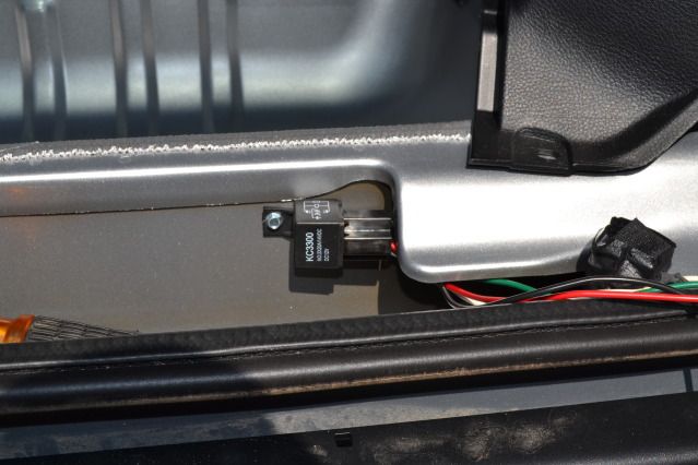

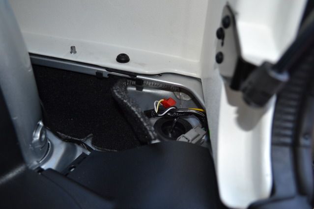

if i understand you right,you want to wire them up to work when in reverse?or do u want to run them any time?i would set up the relay to be triggered when you put the jeep in reverse.i used a single light from my KC back up light kit.no place to really hook up 2 on the back of a jeep.pull the light out and hook up a splice onto the white wire on the back of the housing to trigger ur lites to come on when u put the jeep in reverse.
this is where i put the wire the first try.but i was wrong.the reverse where does not come up into the body.i ran the hot wire to the fuse panel i installed behind the glove box.
but u can get the splice onto the wire coning out of the lite behind the housing.and the screws are side specific.took me a few seconds to figure that one out.
PS......make sure you have plenty of shrink tubing and electrical tape to almost waterproof the connections at the lights.i used coax seal since i had some left over.
