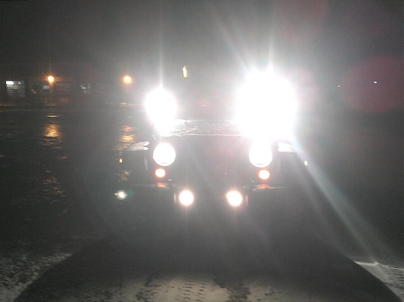

I still like the old school h3lights. Those led lights just look too small to mount up there. And the price! Its a hard pill to swallow

Yea but for brightness and clarity they pretty much destroy every halogen I've ever owned or ran. Sorry....I was on the other side of the fence for a long time, but caved and bought a pair and saw the light....literally. Halogen's are crap compared to the light output of LED's. besides I don't want my rig looking like Mickey Mouse...

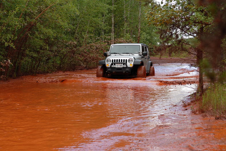

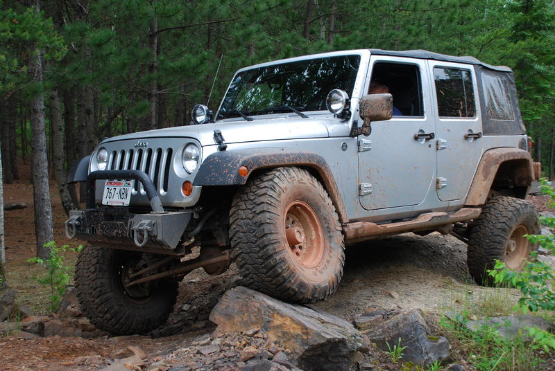

Default Lightforce 170's on Mopar brackets
I have the original Lightforce 170 Striker's with clear filters on mopar brackets which mount the light down and out. I originally had brackets that were more up and in but the back of the Lightforce housing would get in the way of the wipers.
Here are a couple of pic's of my setup that are from a distance. Yes they do block a little of the view from the windshield but it's not as much as you'd think. You get used to it pretty quick. The thing that will throw you for a loop is flipping the switch on those bad boys the first time. There is a lot of ambient light from the filters and the hood. With the filters off it solves that problem but the light reflection from the hood still exists. I don't want to run with out the filters just because it probably helps protect the lenses. My Jeep is silver so the light reflection may be more noticeable than a darker colored Jeep. I've considered putting a flat black vinyl wrap on the hood just for that purpose. I use my lights a lot (almost every night) though.
