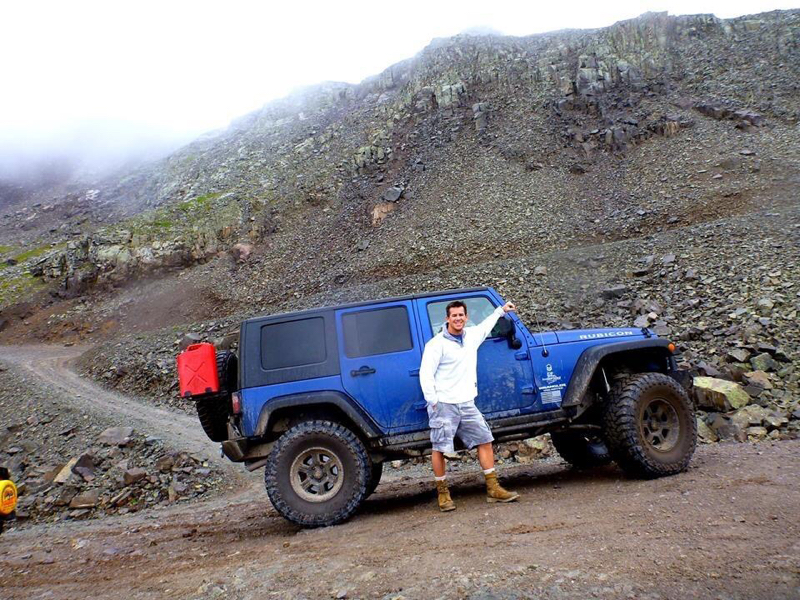

I have a Rubi with stock 4.11's, just trussed only my C's and heavy 37's Toyo Mt's
on my stock Rubi 44. I drove from Dallas to Telluride with family of five. Did every trail with no problem. They are mostly just shelf roads with sharp switchbacks. We then drove to Moab and dos some moderate trails and drove back to Dallas. We had zero issues.
