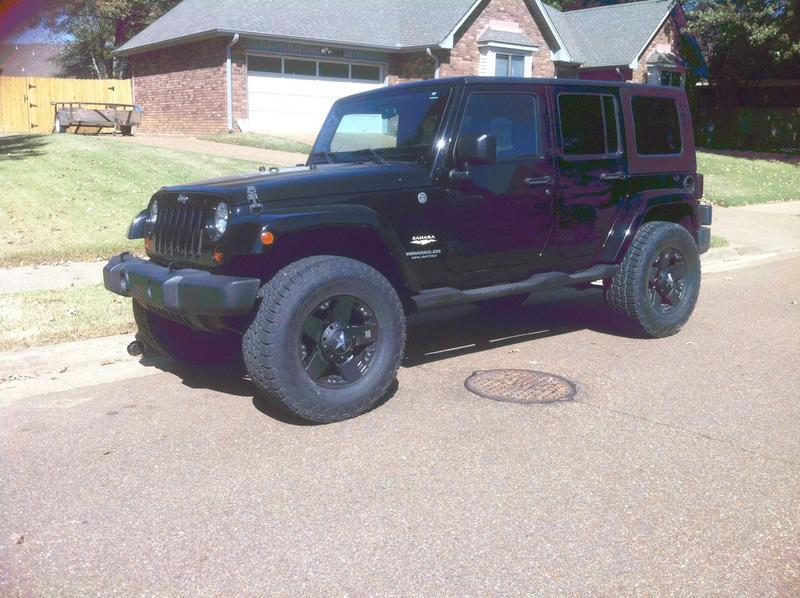

This is my jeep as it sits now...way to close to stock.
Thanks,Attachment 104145
