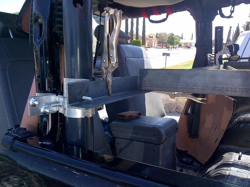

Continuing with assembly, mounting to the front roll cage

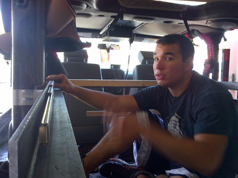

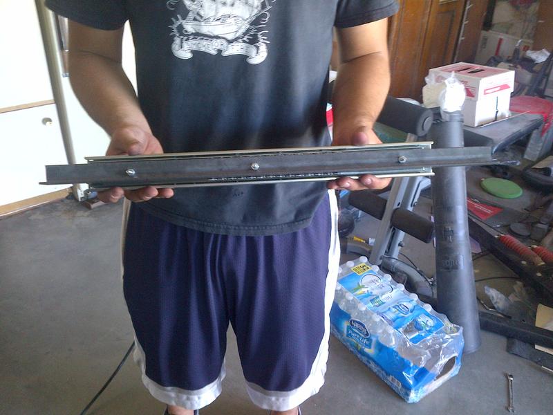

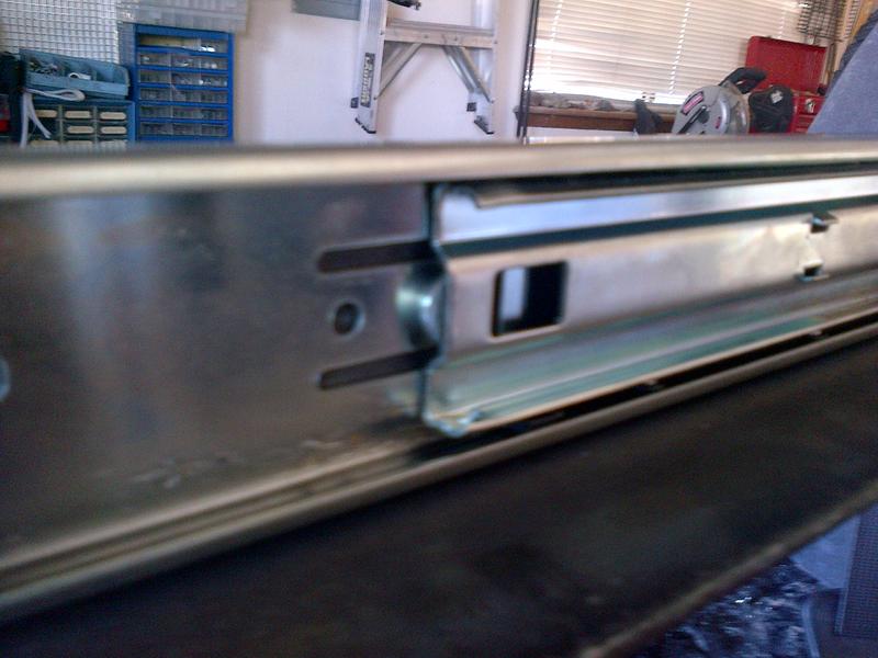

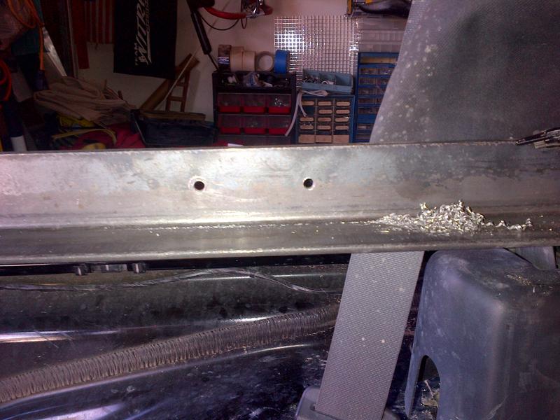

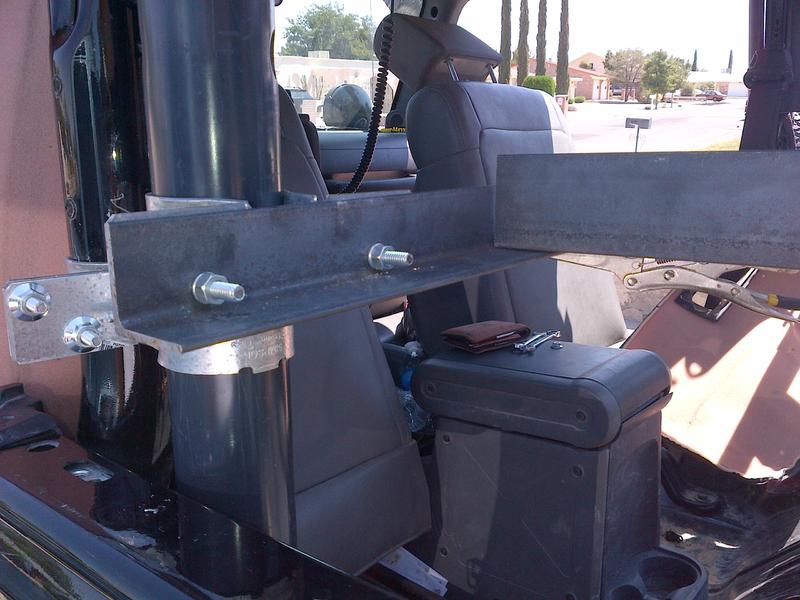

This is where we drilled through the angle iron to bolt on the sliders
for the slider assembly you must also drill through the other angle iron that will be placed on the slider before placing it and bolting it to the main angle iron on the jeep
once bolted on to the jeep the bolts should fit flush and not hit the sliders

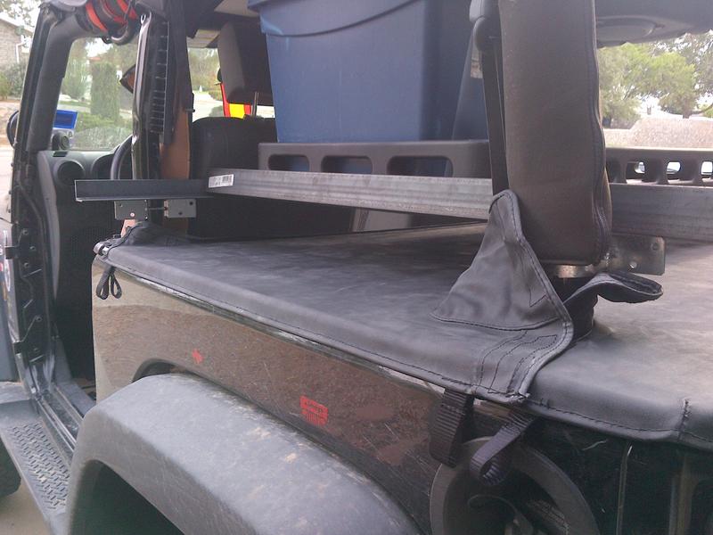

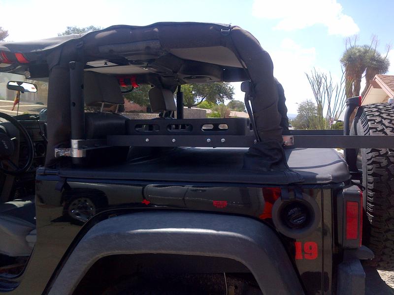

Sliders should fit as such
Once sliders are attached they should be tied together by two more angle irons going across
The basket should sit across the rails like so, do not remove rails simply measure and pre-drill wholes for basket and then bolt on the basket

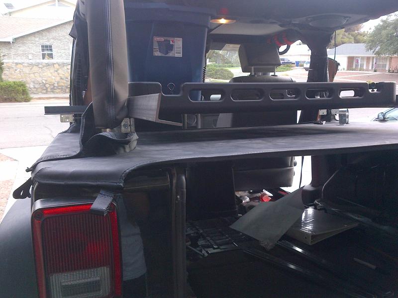

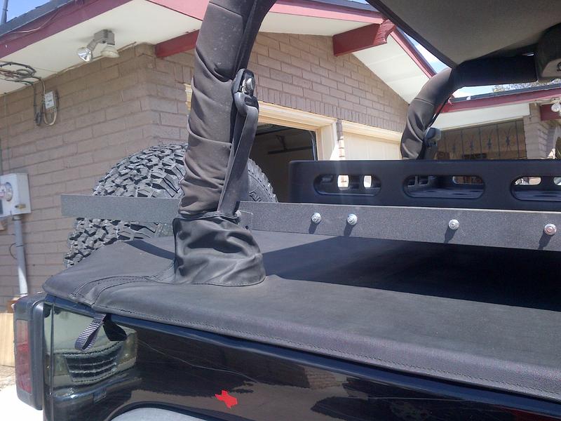

The end result (before paint)

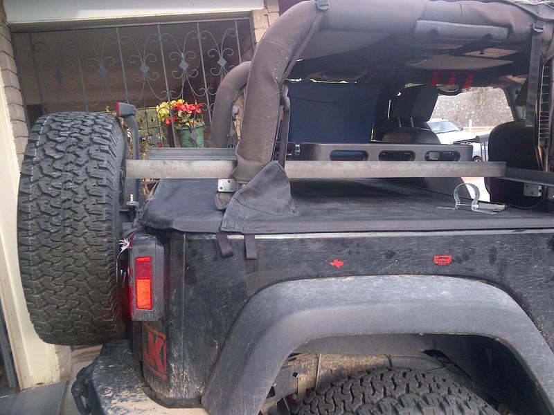

After Paint
Old Sep 17, 2011 | 12:06 PM
txnightwheeler's Avatar
Joined: Jun 2010
Posts: 128
From: Horizon City, tx
Final product after paint

Originally Posted by TCORUM
looking good!
thanks its working really well and can hold more than 200 lbs
